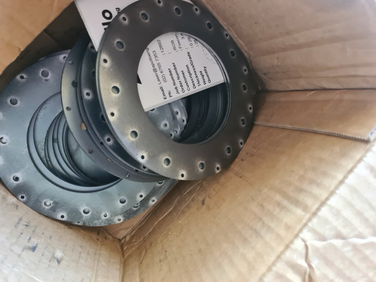

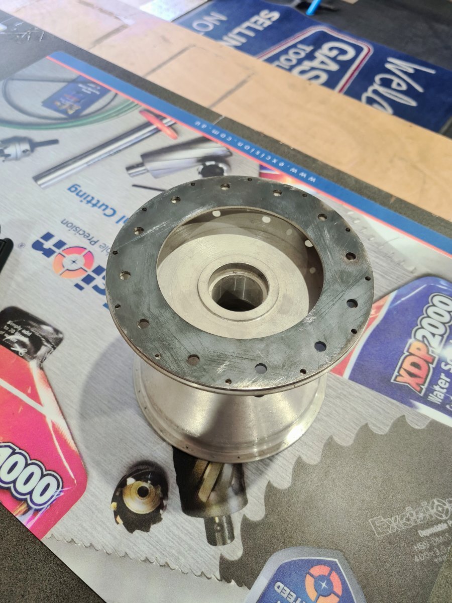

Thanks for the info mate, really appreciate it hey, the discs ill either get laser cut or machine some up myself -

I was going to do just that but one is warped really badly, according to foxcon he just has them laser cut out of mild steel, im doing up a cad file for it now and ill either make some up myself or get some blanks cut etc -

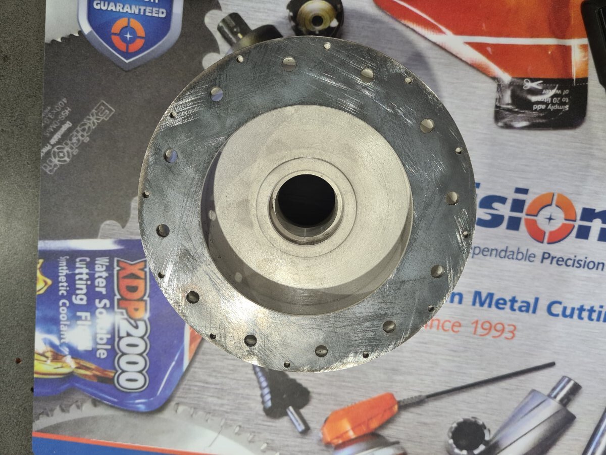

Afternoon, looking to try and find replacement discs to suit these rims. They are a 6" rim and the discs are press riveted, but struggling to identify the rim type or where to get information about the discs etc. If anyone has any info they could share it would be much appreciated.

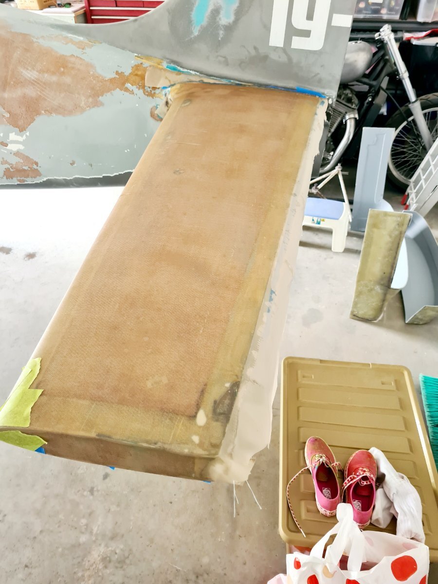

New carbon face finished and relayed tip with carbon reinforcing. Shame to be painting over majority of it but going to stick to the plan, original panel assembly was pretty flimsy......took way longer than it should have Also new avionics ordered today so once i work out where everything is going to sit and where i need to run the new loom and RDAC I can finish off the body work then paint. -

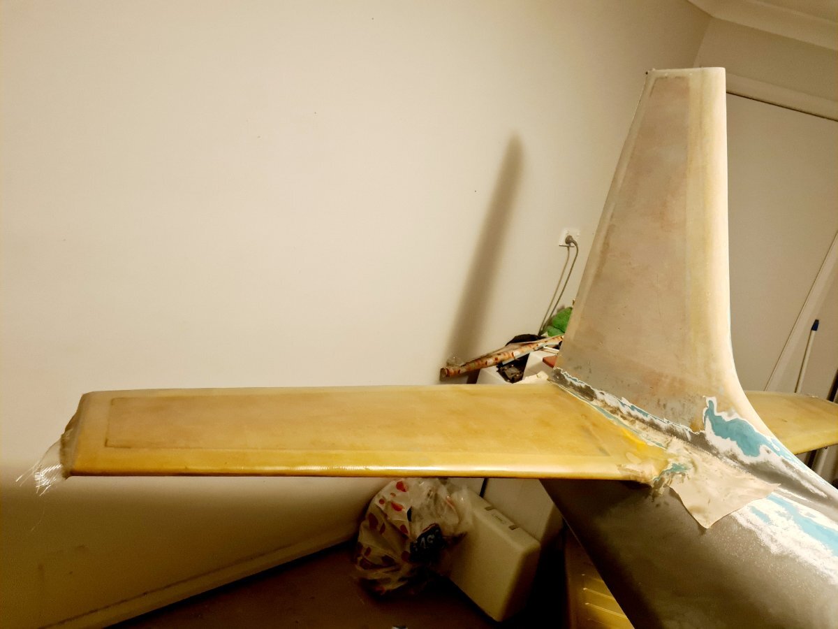

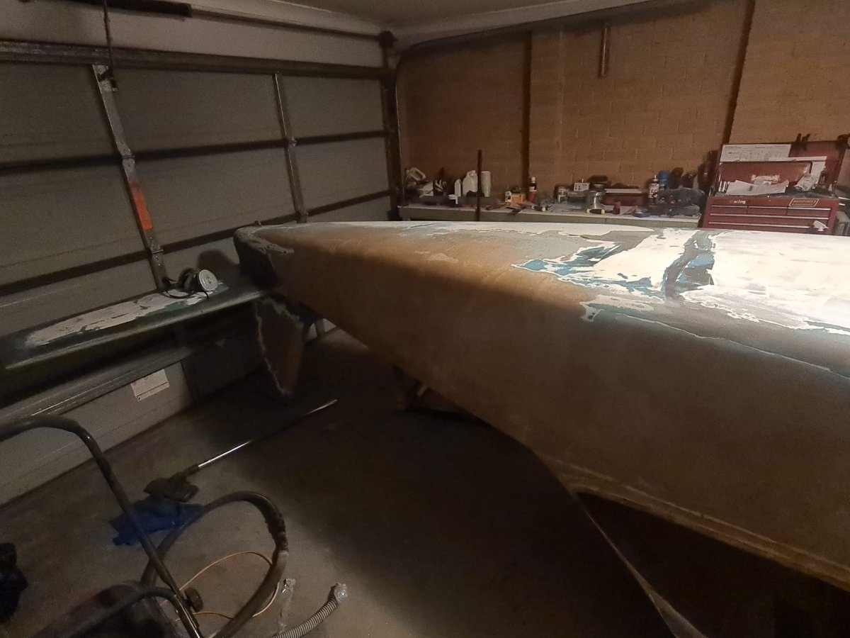

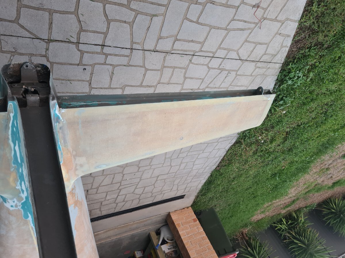

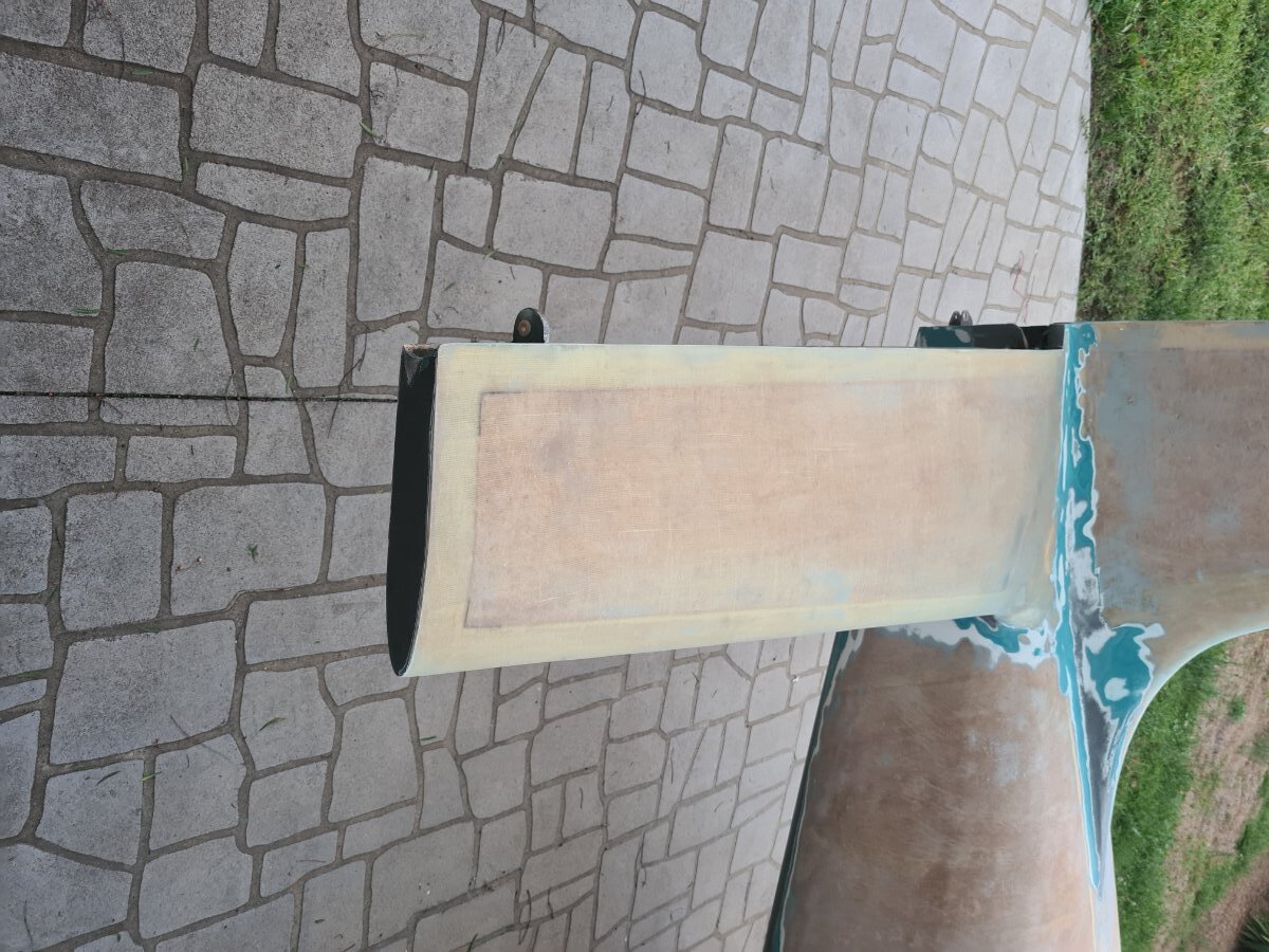

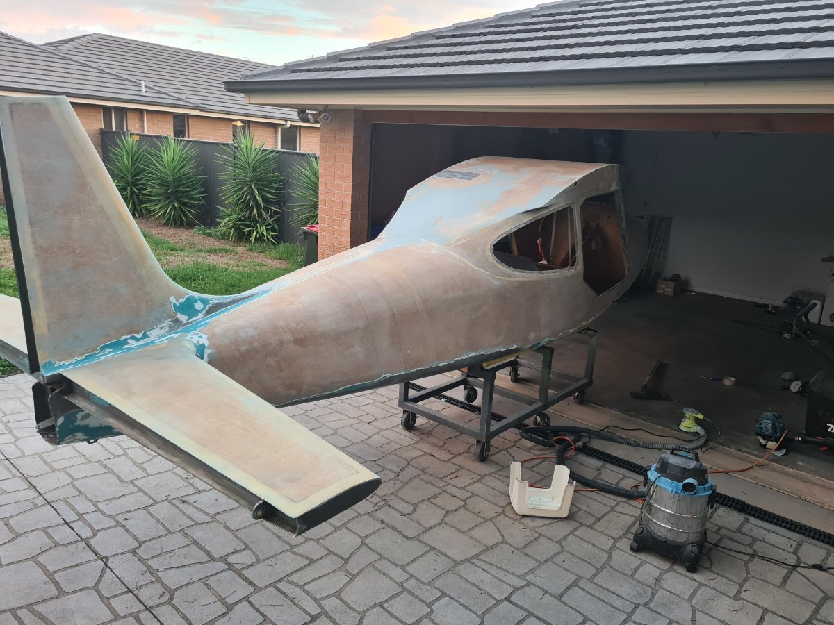

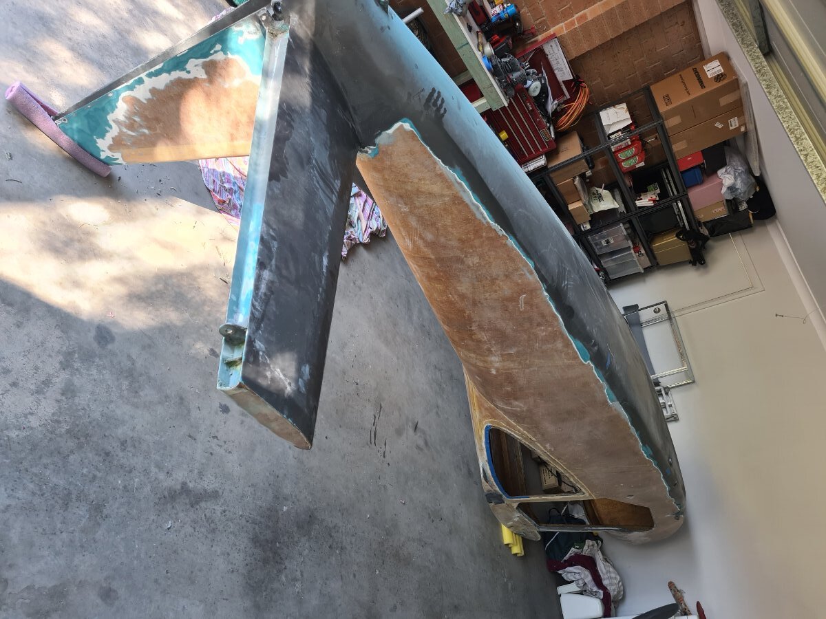

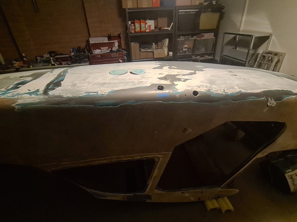

More progress today, have managed get about 8 hours of manual scarping and tidy up work. the original whit was painted over with an aqua colour which i managed to find an original pic of when it was green, then it was repainted in what looks to be like a Galmet Hammertone industrial paint, very thick, which iv attached a pic of as well when it was at Armidale. So.....after experimenting with a few non methylene chloride strippers in small patches, which was extremely timely and had to still be super careful not to damage anything, i decided against any paint stripper. They say methylene chloride Strippers wont affect the Gel coat but i really wasn't that confident in it. after stuffing around with surfacing machines and sanders in patches, i managed to get a few large scrapers from Bunnings which honestly has been the best, for the most part i can take off all layers of paint down to the original primer in one swoop, still have to be careful but once you get a rythm going it rips the paint off in no time. -
