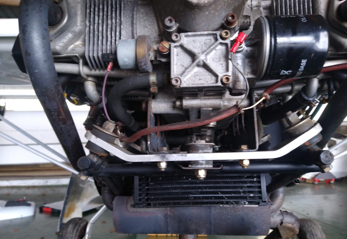

I believe my 20+ year old 80hp 912 uses a 1/8-27 thread for the oil pressure probe. I found this (Honeywell?) which is also 1/8-27 thread, but otherwise it is the new style 4-20mA sensor. Is that a suitable option? EDIT: Disregard, that one isn't 4-20mA but 5V.
Thanks a lot! Unfortunately that doesn't specify how to make the GRT EIS 4000 accept the old style VDO resistance oil pressure probe readings. So I'll have to find the new style Honeywell/Keller probe..

It seems Honeywell/Keller are identical electrically (4mA = 0.75 bar 20mA = 10.75 bar). @Underwood do you remember the sender you bought?

Hi, I have a 912 80hp with the old style VDO Oil Pressure probe. I have recently installed a GRT EIS 4000. Unfortunately, my EIS unit was wrongly configured by GRT Avionics to work only with the new Honeywell/Keller probes. I checked and the Keller probe is 400€ 😞 😞. Also it has a different thread. Is there any alternative probe that is less expensive and is the same style as Honeywelll/Keller so it works with my EIS 4000? Otherwise I have to ship my EIS4000 back to the USA for reprogramming (which can take weeks). Thanks a lot!

GRT support says the EIS4000 can use existing oil/cht sensors. Any recommended EGT sensors and where to obtain them in Europe? Thank you!
