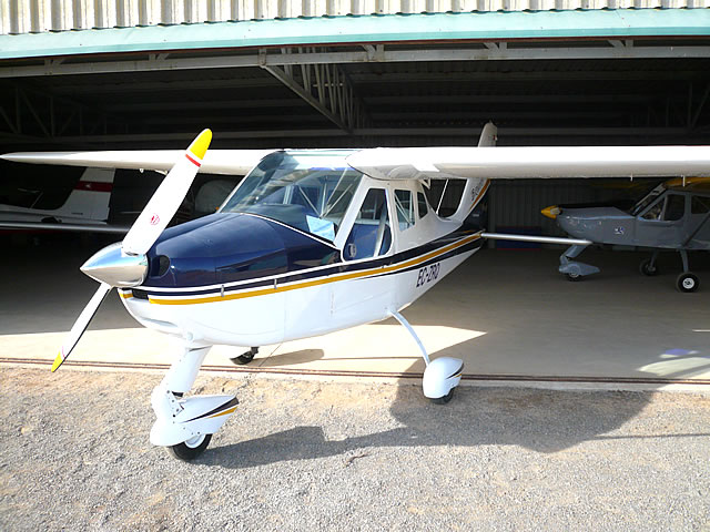

My wife and I took delivery of our Bravo on Friday last, was worth the wait. Take a look on links below. Nigel.
