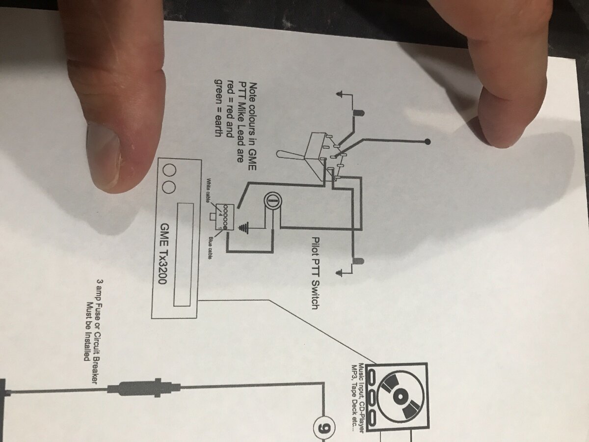

  8. Thank you. The second drawing you sent through, wiring diagram, there's just a few lines that don't have a reference point to terminate to. could you elaborate on the drawing a bit more. what is the thing that looks like a triac and the PTT buttons arrangements please? Much appreciated ben
  9. Just printed a hard copy, will be reading now. Thank you very much!!! BEN
  10. Found this http://www.skiba.com.au/data/resources/av_art/microair.pdf Under costs heading mentions rb-01 transmit module

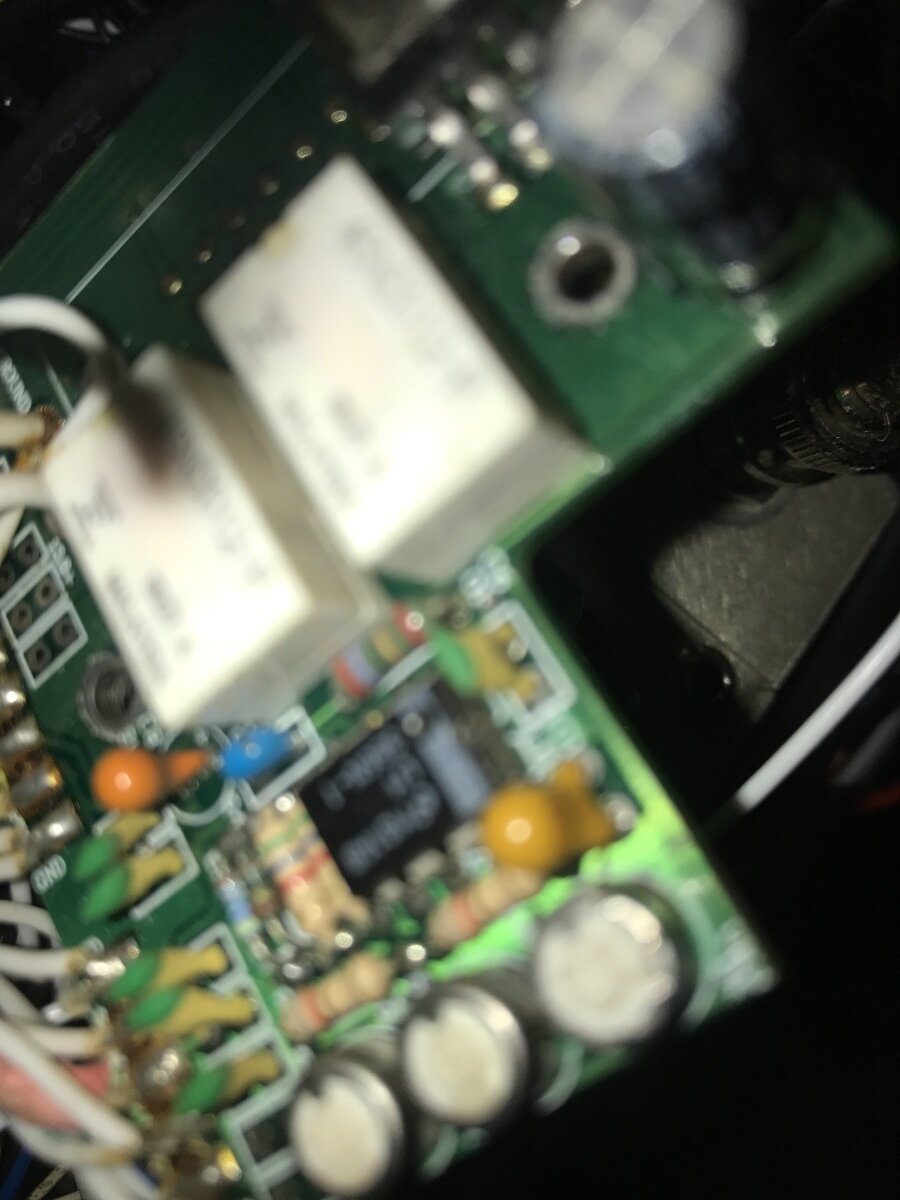

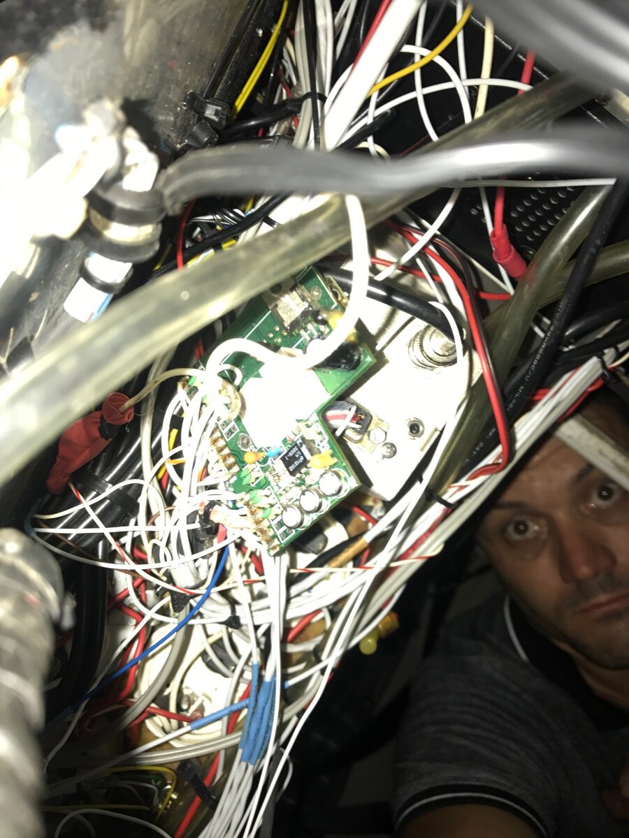

  11. Good morning, i have a Lightwing 912 that has had a radio change prior to my ownership, and the internal switches for uhf/vhf switch over, cuts out all headsets (no mic/intercom nothing). It still has the UHF onboard but when turned on remains in transmit 100% of time, with nothing on headsets. does anyone have information on PCB and it's wiring from factory, as it has a lot of wires cut away from it and floating behind the panel. i am an electrician and have solved a grounding issue in this radio before. thanks in advance ben
