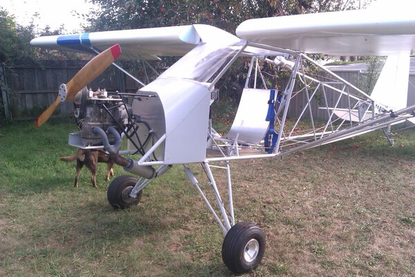

Aero28 Posted April 23, 2012 Share Posted April 23, 2012 Hi All, Took this plane to Temora at Easter and had a favourable reaction to it. I have made a 62" x 38 prop for it and tried it and got 80 lbs of thrust....was a bit impatiant as it was not sanded real smooth, and no clear coat. The old 54" prop gave 110lbs of trust. Next step is finish the prop and a line of white paint on the belts (thanks Andys) and see what I get then. And a tacho Link to comment Share on other sites More sharing options...
aj_richo Posted April 23, 2012 Share Posted April 23, 2012 Note: small variations in the belts manufacture, and machining of each groove in the pulleys, will more than likely mean that the white line will be all over the shop after a run. PS.. You prop sounds pretty coarse for a little Kwaka 440, I would have thought somewhere around 28-29" of pitch Link to comment Share on other sites More sharing options...
