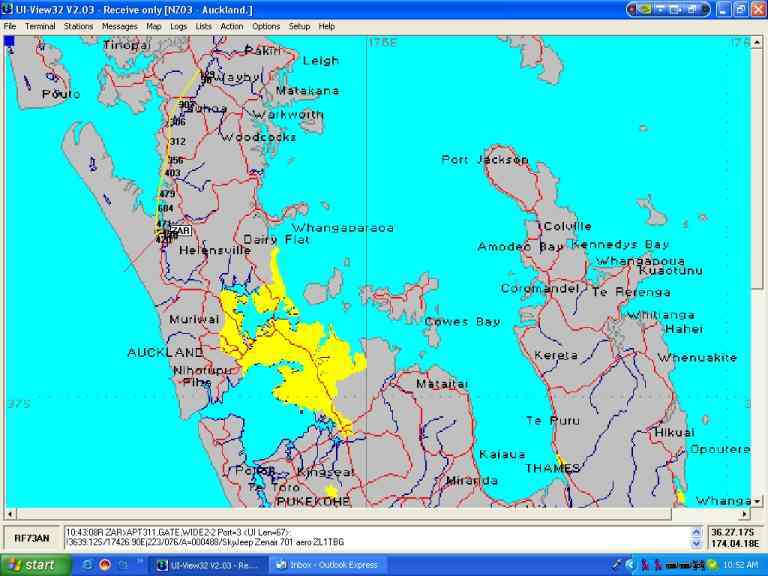

jetboy Posted September 27, 2007 Share Posted September 27, 2007 Attached map of the first HF test with APRS running on a trip from Wayby to Parakai airfield. VHF tests were not so good due to lack of relay sites in the current network. Ralph Link to comment Share on other sites More sharing options...
