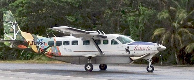

Garfly Posted March 28, 2021 Share Posted March 28, 2021 (edited) Lessons here on decision-making, performance-calcs and, absent all that, canyon-turning. https://en.wikipedia.org/wiki/Nature_Air_Flight_9916 Probable Cause and Findings [NTSB] The National Transportation Safety Board determines the probable cause(s) of this accident to be: The flight crew's failure to maintain airspeed while maneuvering to exit an area of rising terrain, which resulted in an exceedance of the airplane's critical angle of attack and an aerodynamic stall. Contributing to the accident was the flight crew's decision to continue the takeoff toward rising terrain that likely exceeded the airplane's climb capability, the lack of adequate weather reporting available for wind determination, and the lack of documented training for an airport requiring a non-standard departure. Report_CEN18FA063_96543_3_27_2021 10_24_43 PM.pdf Edited March 28, 2021 by Garfly 1 Link to comment Share on other sites More sharing options...
