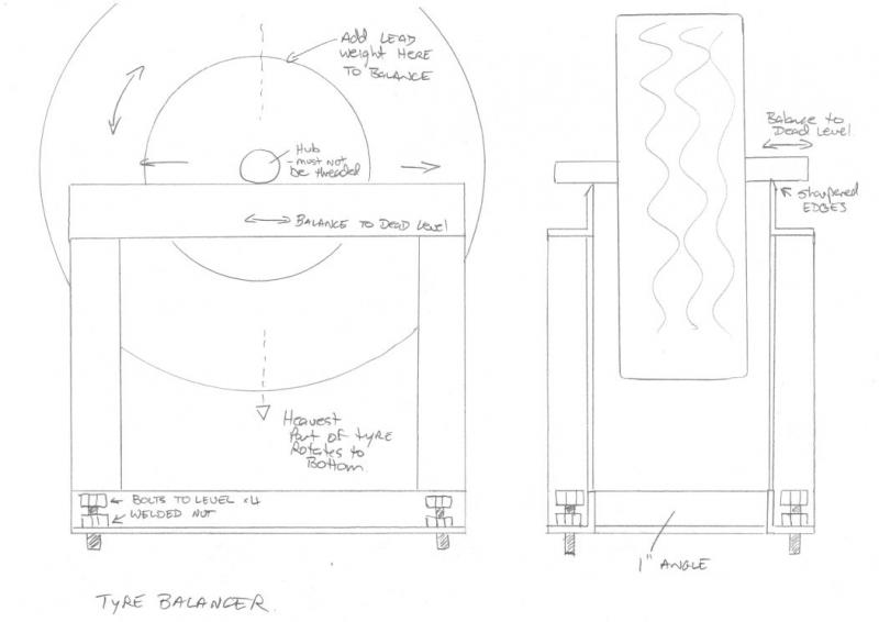

Guest Rocko Posted November 9, 2008 Share Posted November 9, 2008 Used to have terrible probs with vibrating front wheel, just after takeoff. Turned out the wheel desperately needed balancing. Made up a jig to balance the wheel, on 2 adjustable rails. Some lead from a tyre wholesaler, balance nicely, and all was well Fixed nicely the problem. Have use the jig on several aircraft since...proved very handy. Admittedly, I loaned it out, and never got it back, so guess others find it helpful too ;> Scotty Link to comment Share on other sites More sharing options...
robinsm Posted November 9, 2008 Share Posted November 9, 2008 Any chance of getting a drawing of the jig??? Cheers Maynard Link to comment Share on other sites More sharing options...
Guest Rocko Posted November 9, 2008 Share Posted November 9, 2008 Tyre balancer No probs. It's a quick sketch, but hopefully you'll get the idea. The key thing is to have both rails nice and sharp, to minimise friction between axle and the jig, and they must be dead parallel to each other, or all goes to heck ;) Make it big enough, so can use on any tyres and rims. Then someone'll nick it ;> Set it up on a stable bench, use a spirit level to make it absolutely level horizontally across the top, using the threaded bolts to adjust. Once level, either remove the axle with the tyre to use across the rails, or use an equally thick diam metal rod of some sort. Threads screw it up, as we found ;) When put on, the tyre will self-rotate so the heaviest part is down. We used tape to temp stick the lead weights to the rim. Then redo over and over, until it doesn't tend to want to stay at any one point. Clean the rim thoroughly with appropriate solvent, and use the self adhesive on the lead weights to stick in place. The ones we bought only cost a few bucks from any tyre retailler, in all different weights, and have never come off so far. The tyre we did was pretty out of balance. Had to use a surprisingly large amount of weight for an apparently new rim. Took all the wobble from the front wheel on takeoff tho. It was pretty bad before we did it, and annoying as hell in the air as it rotated. Can use on all wheels, but it was the front we really were having probs with. As said earlier, some brakes will stop the others. I really have to track mine down ;> Link to comment Share on other sites More sharing options...
Guest Rocko Posted November 9, 2008 Share Posted November 9, 2008 Again, it's one of those things you'll make up, and only use once in a never. But, when you need it, it's excellent. Then again, it's cheap to make. $10 in angle, and a fewbolts and nuts, and a bit of time with the welder and angle grinder. Link to comment Share on other sites More sharing options...
