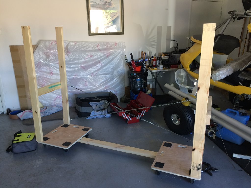

There were two left hand wing brackets. While waiting for a right hand one to arrive, instead of building two left hand wings I built a wing rack. Because I'm building in a two car garage I need to be careful with space. Therefore I made it so the wing is about 760mm off the ground. That way it can sit against the fuselage and over the undercarriage (where the LE tubes are in the photo)
Rack is just built from a couple of dollies, 35x90 pine and a bit of bracing. No glue, just screws so that when everything is done I can reuse most of this in other projects (",)
