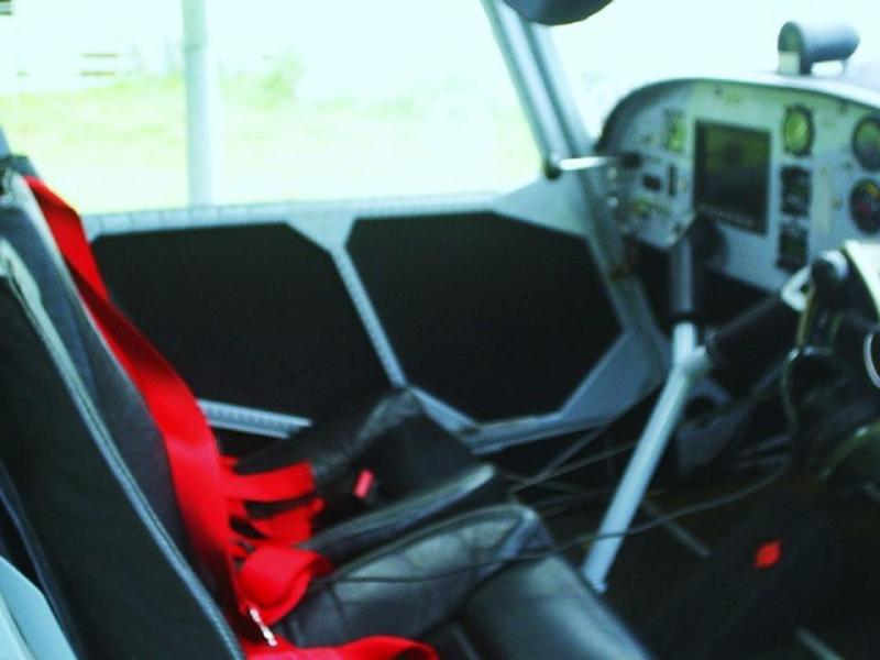

Eric Giles built me a complete new panel and instaslled it out in the field here in Hawaii. He did a great job and he could probably email you a drawing. Basically from left to right. Master, mags, throttle, electric flaps, choke, carb heat. I have electric trim, radio and transponder switches and ptt on Ray Allen stick grip. In the center is my dynon efis. Off to the right radio and transponder then engine gauges, and cabin heat. Above the windshield eric mounted me a moving map gps and there are the toggle switches for strobes, navigation fuel pump and avionics master.
I can work my electric flaps with forefinger while operating throttle. Adjust trim with my thumb on stick. It is a real neat set up.

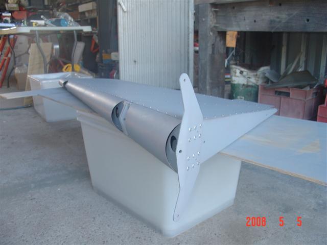

Guest milton56
Gday all,

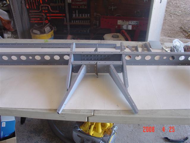

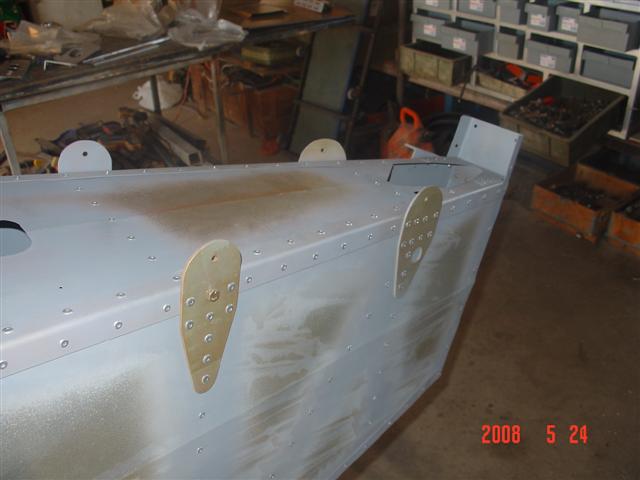

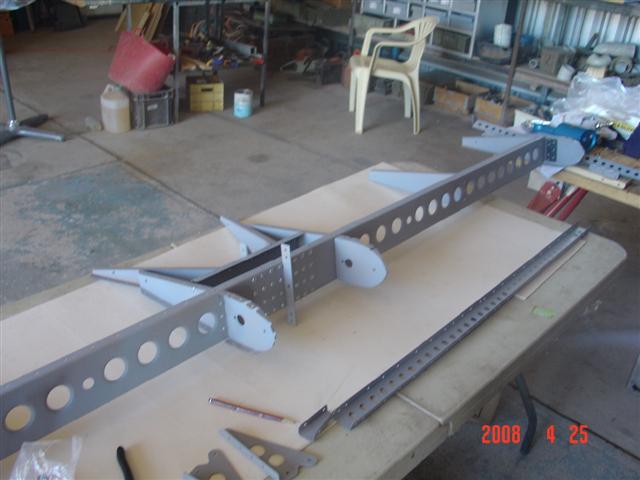

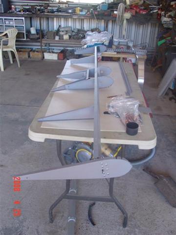

Sorry about the delay of the construction pics but work comes first (well some times apparently). The following shots are the horizontal stabilizer and trim tab.
[ATTACH]6127.vB[/ATTACH] [ATTACH]6128.vB[/ATTACH] [ATTACH]6129.vB[/ATTACH] [ATTACH]6130.vB[/ATTACH]
Regards Milton

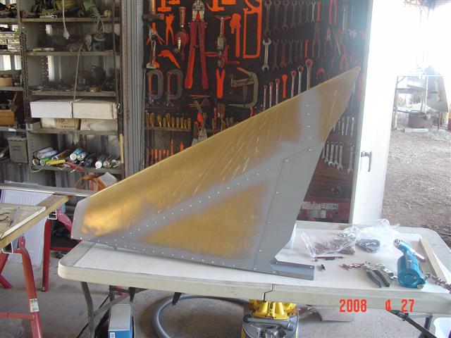

Guest milton56
Hi all,

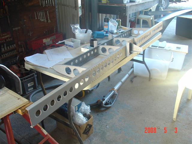

Just some more build pics,
[ATTACH]6279.vB[/ATTACH][ATTACH]6280.vB[/ATTACH][ATTACH]6281.vB[/ATTACH][ATTACH]6282.vB[/ATTACH][ATTACH]6283.vB[/ATTACH]
Regards Milton

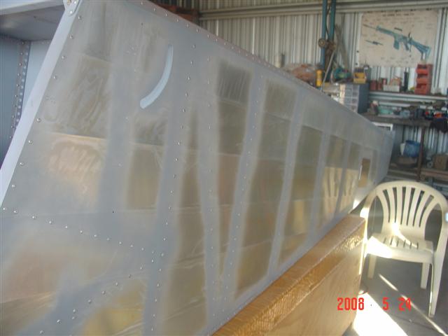

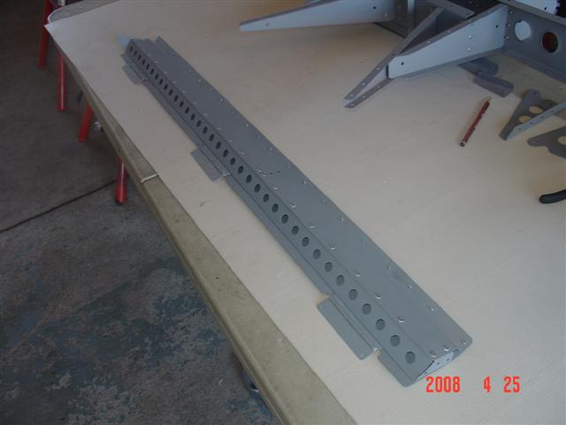

Guest milton56

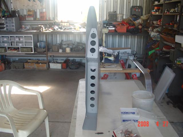

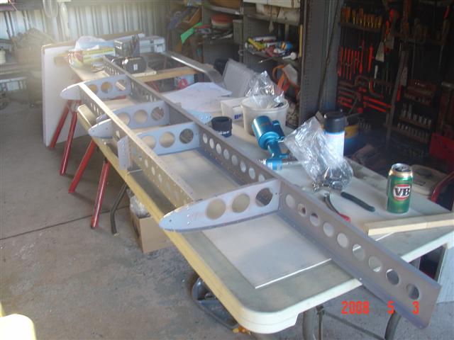

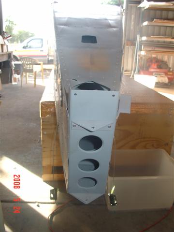

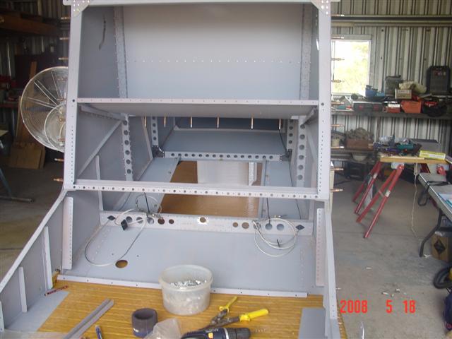

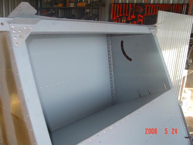

Still more pics,
[ATTACH]6284.vB[/ATTACH][ATTACH]6285.vB[/ATTACH][ATTACH]6286.vB[/ATTACH][ATTACH]6287.vB[/ATTACH][ATTACH]6288.vB[/ATTACH]
The fuselage being built, and as you can see I'm building the plane on the crate that the kit came in. The crate is covered with a bubble type insulation and acts as a protection mat for the parts being assembled. All parts are Alodined and then sprayed with an etch primer.
Regards Milton
