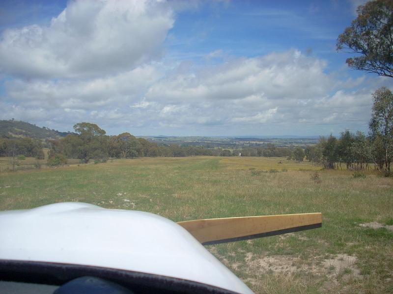

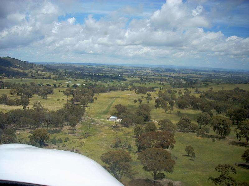

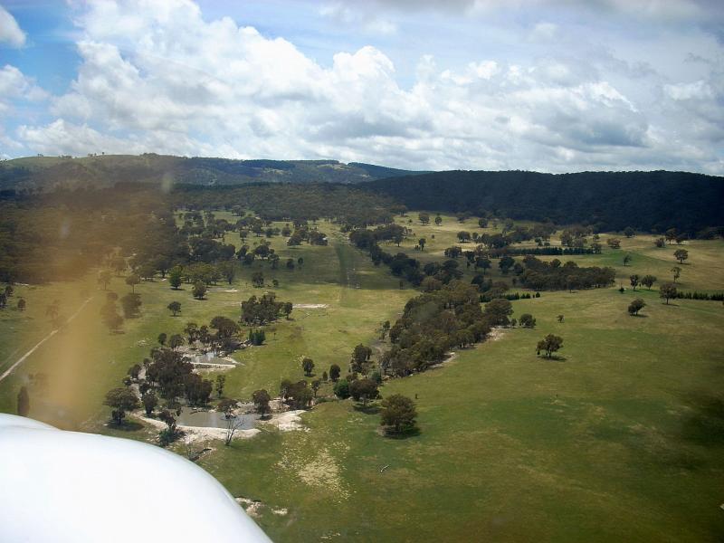

I have had a few enquiries from pilots in our area asking about getting into my strip, so today we took some better pics to provide a clearer perspective of the T/O get-away and landing approaches.
The 'West direction 1' photo shows that clearance is not an issue; the trees in the distance are 1000m way and lower than the horizon.
The 'East direction' photo shows the approach view (uphill). I said earlier that there is no go around option - but what I should have added is "when the a/c is below 50 feet off the deck". A go around to the North is fine, with more starting altitude than 50'.

BTW: The darker green strip of grass is where I have widened the strip - not the full strip. The strip is overall 15m in width.
95224431_InvernessAirstrip-lookingWest(downhill)1.jpg.1ba2a2b4a85b3d073556a28a38c52bd8.jpg
1605655773_InvernessAirstrip-lookingWest(downhill)2.jpg.f27f33f0a8d2c7c9a6ee2d6ccde56373.jpg
599583723_InvernessAirstrip-lookingEast(Uphill).jpg.079222b87557149724288241cad403e0.jpg
