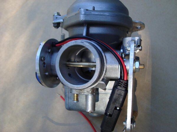

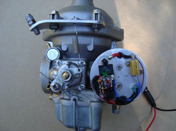

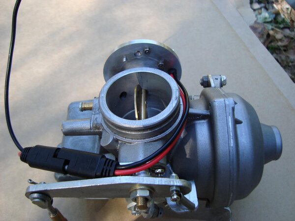

davemac Posted October 30, 2009 Share Posted October 30, 2009 I was cruising around the net the other night and found this:Carb & Induction It seems to be an alternative for anti-ice of bing carbs. Has anyone tried it? What do you reckon? Hi Y'All, I built a similar unit for my Rotec R2800. I used a Hi Power transisitor switched by a thermistor that turns Off about 20 deg C. The heat source is the heatsink for the transistor; total cost about $40. I was not happy with a resistor heating all the time with no temperature control. I tested it by cold soaking the Bing in a freezer to about -5C, then turning on the anti-ice, with the unit still in the freezer. The butterfly came up to +2c within a minute and then climbed about 5 C every minute until it hit the thermistor value of 20C where it cycled On and OFF between 18 and 20 C. The unit is about 50mm in Dia and 20mm thick, it draws about 2 amp continuous (30 watts), 5 amp max(70watts) on turn on. I connected it through a switched CB rated at 10 amp. BR davemac Link to comment Share on other sites More sharing options...
davemac Posted October 31, 2009 Share Posted October 31, 2009 Shown without the cover, the base plate was sized to take the lid of a spray paint can. the unit screws onto the butterfly boss for heat transfer to the carb body around the butterfly. The transistor dumps its heat into the base plate which acts as a heat accumulator. Since the unit cycles at around 20C, it is a 'switch on and forget' jobbie. I have a small LED that comes on with the cycling power as a confidence light. I have flown it for 6 hours now but since I have not been in icing conditions to my knowledge, I cannot really say if it disperses ice. Similar units with the resistor referred to to in the original post, are in use in Canada and Europe, so I figure the concept of a warm butterfly is sound. Link to comment Share on other sites More sharing options...
