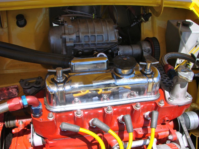

Tomo Posted January 12, 2010 Posted January 12, 2010 Ok so check out the supercharger, in a mini... [ATTACH]9665.vB[/ATTACH] And it's not mine either! I got a naturally 'in-spirated' ute... (doesn't need help from anything else... ;) )
Guest Qwerty Posted January 12, 2010 Posted January 12, 2010 Quote Ok so check out the supercharger, in a mini... [ATTACH]14546[/ATTACH] And it's not mine either! I got a naturally 'in-spirated' ute... (doesn't need help from anything else... ;) ) After all that talk about turbos, he shows us a blower....you are a bloody legend Tomo.
