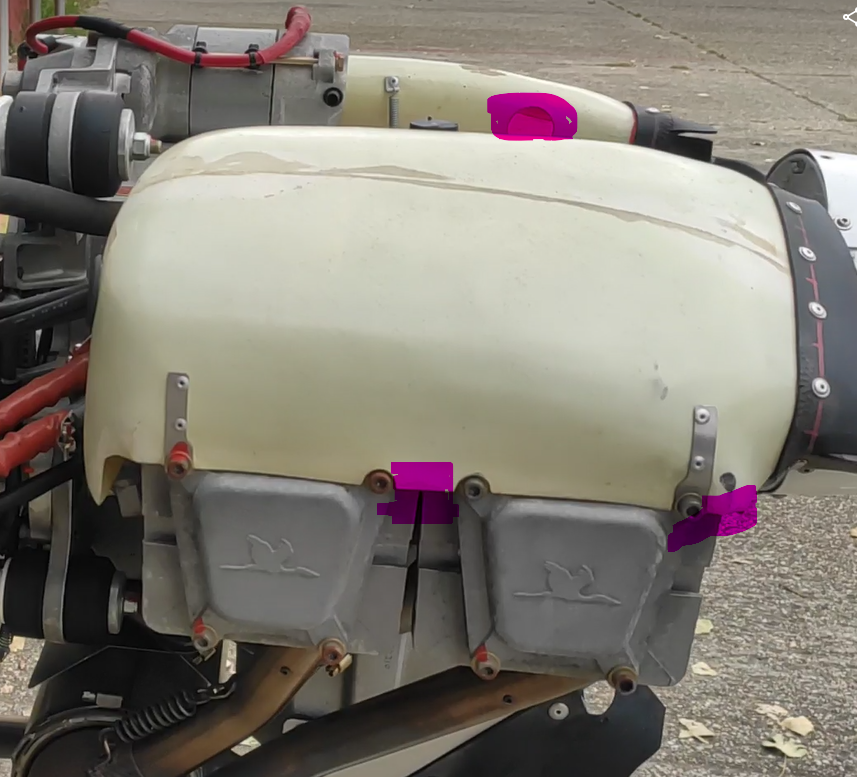

Thanks to everyone for the replies so far. You gave me great ideas and I am optimistic! I'm done with a small modification, but I've been sick, so unfortunately I haven't been able to reassemble and test it, but maybe soon. I still have a lot of faith in increasing the speed, and I try to block the air leaks before the first test. My question is, what kind of material should I use there, which can be shaped well and withstands the necessary heat? A rubber sheet would be good, for example, or epoxy resin painted and glued on fiberglass, or what would anyone recommend for sealing? In the attached image, I have marked in magenta what I want to block from the outflow path. I also found two rather large holes on the inner side of both flow pipes (also colored in the picture) that I would block. Maybe it would be used to connect the ignition cable, but I think I won't have a problem with it if I don't have a cable there and seal it.
