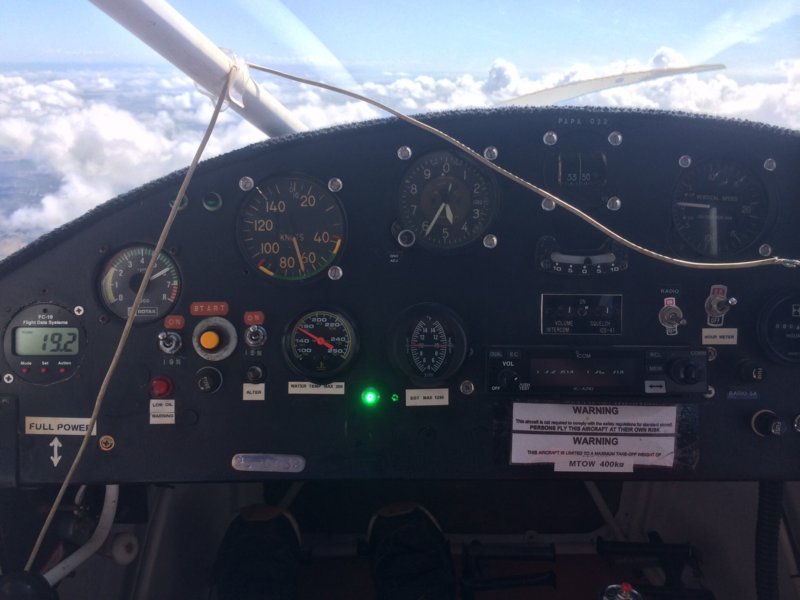

As for oo32 she will easily do the same but now the rules have changed and she has to comply with the 400 kg mtow Because she is lw- oo1 model .
Yes I belive I could do the upgrades witch in vole a brace in the wings and an upgrade of the front cross brace above ya head to bring her to a mtow of 450 kg but I won't be going down that path I carry 98 litres of fuel for those long trip on my own with camping gear and when flying two up I only use the standard tanks 66 litres
