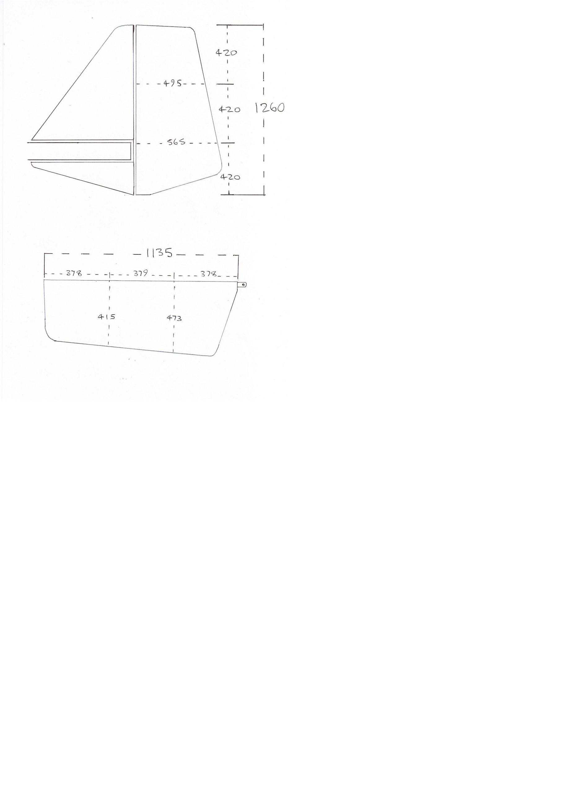

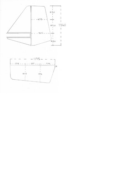

Skyhog Posted February 17, 2008 Share Posted February 17, 2008 Ok Tony,here we go.I have done an illustration for you,I hope it loads OK.You should be able to zoom in alright after you open it.Like you requested earlier ALL measurements are INTERNAL.It is not to scale but all the measurements are very accurate.Cheers. PS You should receive my TOSG renewal cheque by today or tomorrow. Link to comment Share on other sites More sharing options...
Guest TOSGcentral Posted February 18, 2008 Share Posted February 18, 2008 Good stuff Skyhog. Exactly what I wanted. I will get onto it today and measure up one of the Glasshouses and get a set made for you. Give me a PM with your mail address and you will get them shortly. Try them for fit and if satisfied then send the filthy money - exactly the same as already quoted as there should not be much difference to the task and materials. If yours works OK then I will cut out master templates and will make them available to any Gemini as well. Aye Tony Link to comment Share on other sites More sharing options...

Guest TOSGcentral Posted February 20, 2008 Share Posted February 20, 2008 Hi Sportsfans, We limp along! I am attaching two images – one of the kits for the labelled Gemini formers and one of the existing TST/T300/T500 formers. There is one difference in that instead of the two rolls of tape shown you will be getting a single much larger roll of tape with the kit.. Gary – we are working directly off your internal measurements so these things should go straight in. However, I do request your return input on both fitting and flying. In the flying area you should have no problem at all – just controls that work better without the machine becoming at all ‘twitchy’. Any problems then talk to me. The slightly downside to this is that we have to increase price for the Gemini formers to $55 inclusive of postage and packing. With the 1†diameter frames a great deal of time is required carefully sanding out the indents at each end for a good fit. But our deal with you still stands Gary – try them and see if you are satisfied before paying. Images (click on images to enlarge). The standard T series kit. The new Gemini kit (actually the one that Lois is putting in the post for Gary while I am writing this) Aye Tony Link to comment Share on other sites More sharing options...
