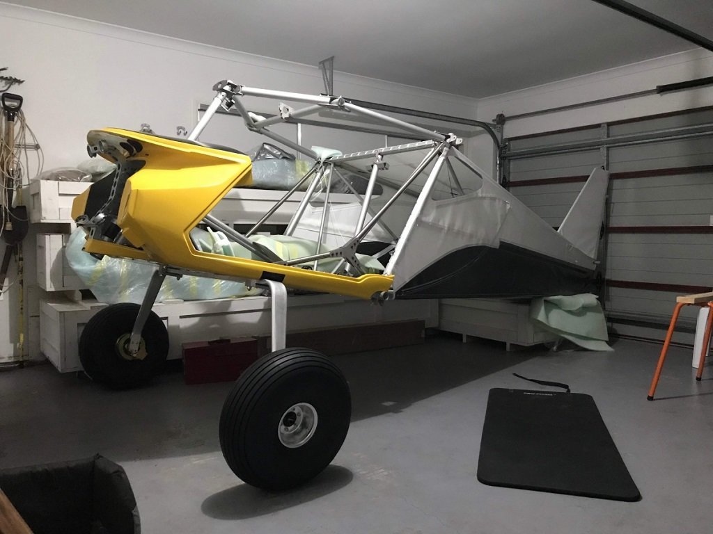

As good a point as any to post an updated picture. The battery was a dam tight fit and im not looking forward to having to replace that one day!
Putting on the undercarriage and wheels was pretty straight forward. Be aware that some of the items come pre assembled even though the manual has assembly instructions. Things like the disk brakes definitely need tightening up and Loctite used.
the seat backs had a hole too small for the clevis pins so I needed to drill them out

Looking Good.      What size tire's are those?  I'm planning on building my Bushcat in my 2 1/2 car garage as well,   Think I may need some small dummy tires to be able to roll it out of the garage.
They are 850 x 6 airtrac
on the garage question. First thing we did was decant the largest crate with the large fibreglass parts. That crate ended up as my partners sons doghouse:)
we we really wanted to hang on to the other crates because they looked useful. Soon after we stacked up the three you can see behind the plane we hired a trailer and dumped them. Just took up too much room. You may have more room than us of course and it would have been better to kee everything in the big crate as it did get tiring shuffling the pieces around all the time!
