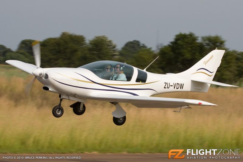

Spin Posted May 31, 2010 Share Posted May 31, 2010 I've just heard that a VL-3 Sprint, sold in South Africa as the Flamingo suffered an in flight break up and crashed over the weekend, killing the pilot and passenger. The aircraft, a sleek looking composite retractable, powered by a 100hp Rotax, may not even be sold in Australia for all I know, but the lessons that are already coming out of this accident are well worth pondering. The plane and crew were competing in the annual Presidents Trophy Air Race and were observed in a shallow decent from high ground to low, heading for one of the turning points that has to be rounded at between 200 and 300 feet agl. From what eye witnesses have said, it seems the wings separated from the fuselage, in flight and were severely damaged - torn apart is one description I heard. Flutter is the obvious conclusion, but why it occurred remains to be seen. Now I may be the only idiot that missed that page in the book, but I always understood that VNE was an IAS number ie. redline on the asi was an absolute, however I am now told that this is not necessarily so and particularly composite manufacturers, sometimes reflect VNE as a TAS figure. VNE on this particular aircraft is shown as either 162 kts or 183 kts on the various agents and manufacturers websites, however max speed in level flight is already 145kts, so it doesn't take much imagination to see that in a competitive situation with the throttle against the dash, the aircraft could exceed VNE relatively easily in a dive. For me two things stand out - 1. know your aircraft's limits as set out in the manual ( and understand what they represent), and 2. coloured bands on the asi aren't there to make it pretty, they represent safe limits, determined by whatever testing the manufacturer has done. Exceed them by any margin and you just joined the test pilot program. Link to comment Share on other sites More sharing options...
Spin Posted May 31, 2010 Author Share Posted May 31, 2010 Found a photo of the aircraft, source as indicated on the image. Link to comment Share on other sites More sharing options...
