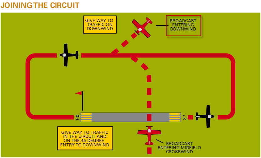

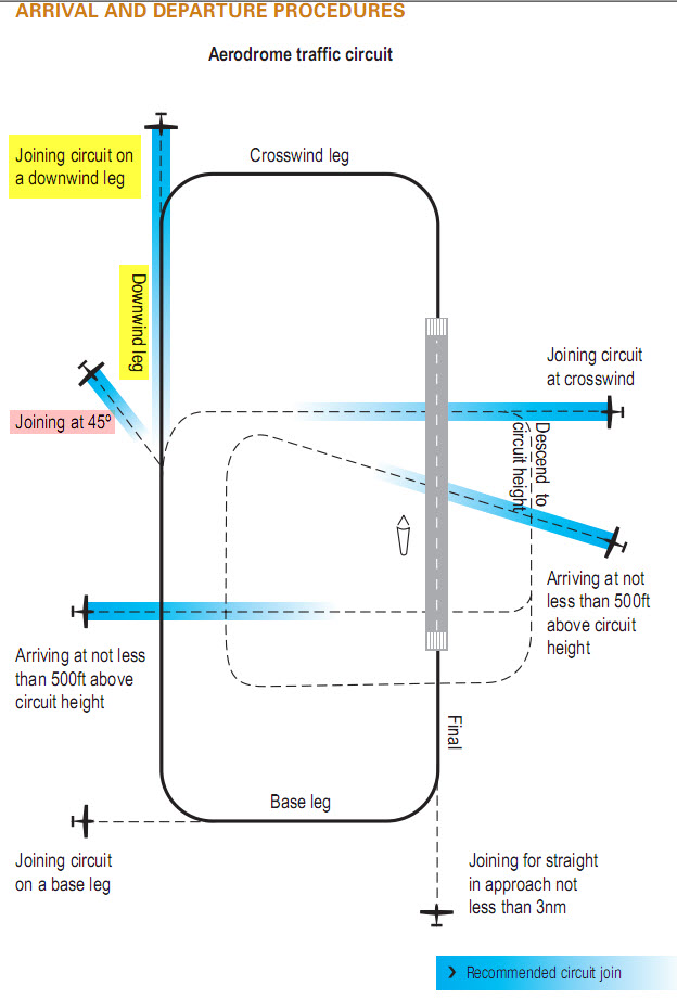

JayKay Posted June 15, 2010 Posted June 15, 2010 Pre 3 June 2010 an "entering downwind" circuit call meant that you were joining the circuit at 45 degrees from the active side approximately mid runway. (See diagram below from the VFRG ver 2 page 239) The new circuit rules which became effective on 3 June 2010 show the "joining downwind" circuit call is to be made when joining the circuit in line with the downwind leg - extended backwards. (See diagram below from the VFRG ver 4 page 242) What then do we now say on the radio when joining the circuit on the downwind leg at 45 degrees from the active side? "... Joining at 45 degrees for ..."?? :confused: We can't call in "... entering downwind ..." anymore because that is now a valid call for a new circuit join location. I also note then we used to 'enter' circuits, but now we 'join' circuits. I further note that what used to be known as "... entering midfield crosswind ..." is now known as "... joining crosswind ..." but the location of entry is identical. These are serious issues because when other pilots are making these calls they are giving us the big hint via radio WHERE TO LOOK for their aircraft when in circuit. If our understanding of the circuit locations is different then life in circuit will only get more stressful and dangerous. But then again, some might say that "If you didn't know about these changes until now, they are not the sort of changes that will have endangered your flying because the only procedure that you wouldn't have known about is the joining on base leg." So do we now call the old "... entering downwind ..." the "... joining at 45 degrees ..."?
