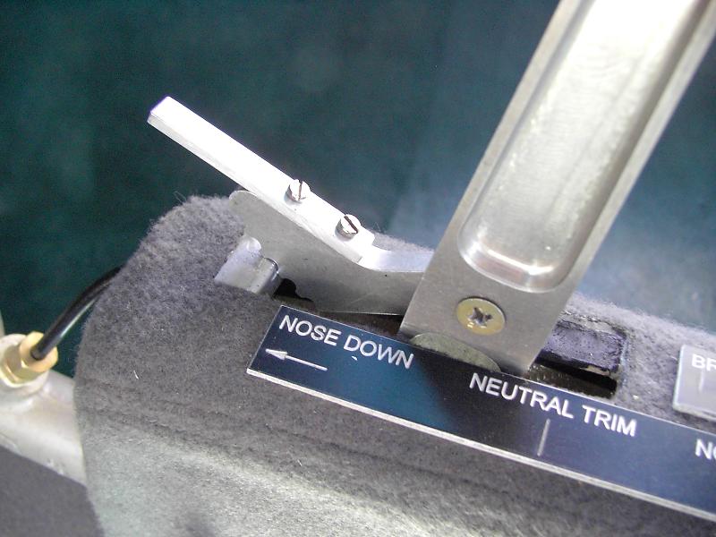

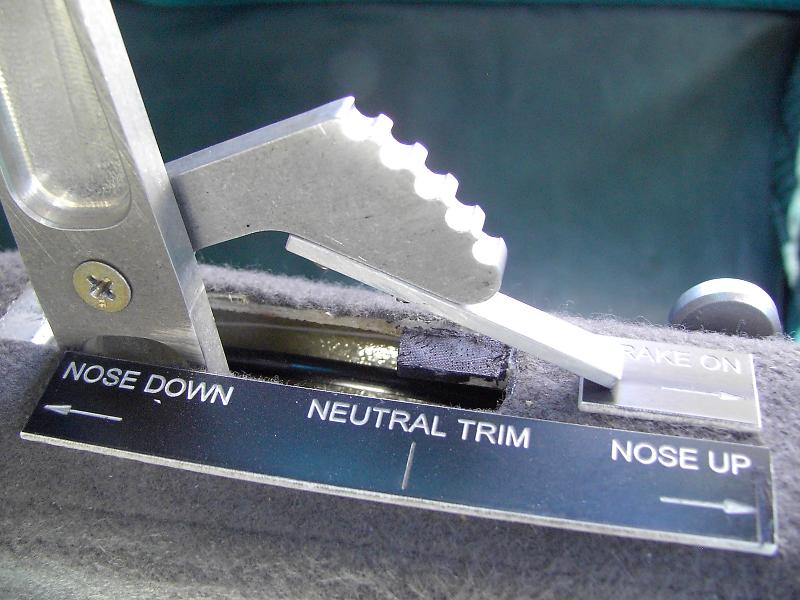

Guest Ken deVos Posted February 6, 2007 Share Posted February 6, 2007 Brake lever ratchet Is there a good fix for the annoying habit of the brake ratchet running out of teeth, rotating past the last segment and then falling through the opening? I imagine this problem is caused by progressive brake pad wear and the ratchet simply runs out of travel to compensate. Recently, when parking at a windy ALA, I needed to roll up my weather briefing sheet and jam it in the slot so the ratchet had something to grip. Link to comment Share on other sites More sharing options...

Guest brentc Posted February 7, 2007 Share Posted February 7, 2007 After hundreds of hours in the Jab I can tell you that if the handbrake ratchet is not ratcheting (don't know if that's actually a word), then the brakes need adjusting. It doesn't take more than a minute or two to tweak up the brake calipers every 10-20 hours or so. The problem is that if you don't tweak up the calipers and the pads have worn, the piston can come out too far from the housing, cock sideways and the fluid will leak out and you will have no brakes whatsoever, a very dangerous situation. Another idea Ken might be to apply the handbrake after switching the engine off so as to avoid the requirement for 2 sets of hands. One thing that annoys me about many Jabs is the high idle that people set them at. 800 rpm on the ground is more like 1,000 in the air. If you're on final and trying to slow down and land it short you will be pulled along by the engine which will frustrate you and circumvent your short-field technique. I set my idle to as low as it can go without stalling for ground use, then in the air when I throttle back on final, it won't go below 800rpm. The bonus of this is a much slower approach with a shorter landing. OME, oil consumption is not usually an issue, however if the aircraft required 800mls to get it back to the mark again, I would suggest taking to the pilot that last flew it. You need not fill the oil level past the bottom mark, otherwise the excess will blow out. This is a documented Jabiru fix on their website for blow-by problems. Link to comment Share on other sites More sharing options...

BigPete Posted February 10, 2007 Share Posted February 10, 2007 My Brake Mod This is how I solved the problem of the missing ratchet. Just a small strip of aluminium screwed to the top of the ratchet. regards Link to comment Share on other sites More sharing options...
