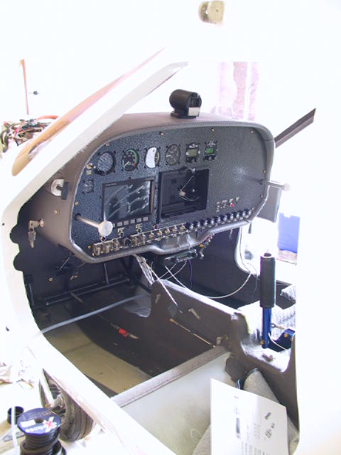

Guest brentc Posted March 5, 2007 Share Posted March 5, 2007 Hello All. Thought I'd post this for your interest. This is the latest J230 LSA from the factory (factory built). It came down from Bundaberg last week prior to heading off to Perth on Tuesday. It goes nicely and has lots of extra's. TAS is around 120 knots in the cruise at 2,800rpm around 1,500 - 2,000 ft. For those with J200 - J230's, you might notice that the header tank has now been placed at the rear under where the rear seat would go if it was a 4-seater. It seems that this was required as the Positec cooler is quite a bit heavier than the old one. Link to comment Share on other sites More sharing options...

Guest brentc Posted March 6, 2007 Share Posted March 6, 2007 Speaking of agricultural, how about the crappy springs on the pedals in the pic I have posted of the dash? It has to be the cheapest looking addition I have seen for a long time. I've not seen that on another J series aircraft before. Most unimpressive. Alan, I was wondering if you could run your operating temps past me. Do you know what your oil temp in the cruise is and and what it maxes at? Personally I find the J160 a dream to fly. Lots more room than the J230/J430 and feels like a solid aircraft. I've never experienced any dodgey flare behaviour. One problem with the J160 is directional control when landing and dropping the nose down. Many a people have come close or have actually come un-stuck when steering. It's frustrating as this could be easily solved by replacing the front tyre with a round one rather than that big standard square one that they fit. The new J230 in my pic has some elaborate new guages in the wing root, along with the dash mounted LED ones. This seems to work ok. BC Link to comment Share on other sites More sharing options...
