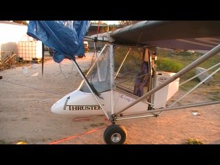

flyerme Posted September 24, 2011 Share Posted September 24, 2011 Hello during inspection we could not find a i.d number? it was on the intrument panel in my old Bunyip but can't seem to find it on my new Thruster.it may have a new insrument panel as it appears no be velour on masonite.and not alloy. P.S I m pretty sure I'v got a new world record!!!most amount of dirt and gravel shoveled in a week..have to had dig/shovel dirt in to my 6X4 trailer then shovel it back out on to my Lime rock strip..im half way at 150 meters has taken a week and have shoveled.dug and mined 76 trailer loads working from 5am to 6m pm evrery day ,having a day off to rest my back and my cripped fused foot...are 1/2 way and she looks pretty good..wellllll..hmmmm;good enough Link to comment Share on other sites More sharing options...

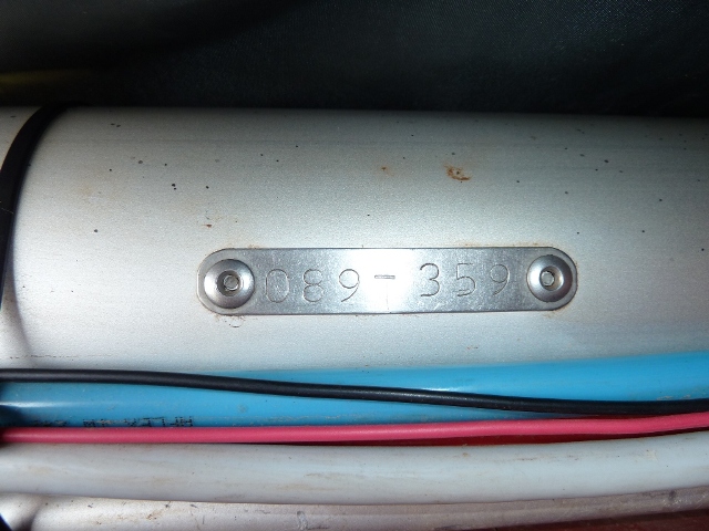

pudestcon Posted September 24, 2011 Share Posted September 24, 2011 I assume you are talking about the manufacturing ID number, and not the registration number? The 'compliance' plate number is generally a small ss plate pop riveted to the main fuselage boom above the cockpit port side - above where the pilot sits. The number usually starts with the year of manufacture (089 being 1989) and finishes with the number of aircraft that have been manufactured (359) so the examples here would look like "089 - 359" Hope this helps. Pud Link to comment Share on other sites More sharing options...

pudestcon Posted September 24, 2011 Share Posted September 24, 2011 I assume you are talking about the manufacturing ID number, and not the registration number? The 'compliance' plate number is generally a small ss plate pop riveted to the main fuselage boom above the cockpit port side - above where the pilot sits. The number usually starts with the year of manufacture (089 being 1989) and finishes with the number of aircraft that have been manufactured (359) so the examples here would look like "089 - 359"Hope this helps. Pud You are looking for something like this flyerme Pud Link to comment Share on other sites More sharing options...

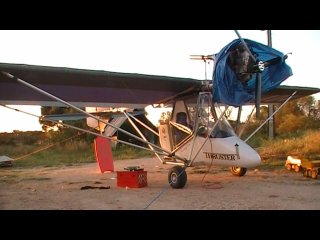

flyerme Posted September 26, 2011 Author Share Posted September 26, 2011 on the early single seaters the the serial numbers were stamped on the end of the aluminium engine mountscheers corky Hello,just did a complete and thourough look over, could not find a plate still and also looked for rivets or rivet holes and nothing?I should mention its still running the origanal fuji robin 50hp and appears to have origanal alloy engine mounts..what has been removed and replaced were the wing box's,new mild steel fitted(raa phoned and noted)..I dont have a lot of history other than it was inspected in 1990 at mt,gambier by a Lyall Sharam then in 2009 it was inspected in nsw(somwhere near Sydney),wing box replaced and flown(total 3.5 hours logged),I bought this from another owner with no log book,no licence, (as he was a farm flyer who flew it on his own property{apperentlythe raa rules state no licence or reg required if flown on and within own property} wich he flew the day of purchace. other than that all I know is its a modified T83, one of 49 built...mods are : endurence tank and spoiler fitted, rear cabin new full alloy sheet fitted(to fill in cockpit) new doors fitted and a 3 blade brolga fitted..I was yold this eas done very early in its life..? Link to comment Share on other sites More sharing options...

flyerme Posted October 21, 2011 Author Share Posted October 21, 2011 JUST BEEN GIVEN A LOGICAL EXPLANATION............. NOT the origanal boom ... ah of coarse ..why didn't I think of that? well they could have re-riverted the i.d back on ofater stacking it ,,proberbly a ground loop Link to comment Share on other sites More sharing options...
