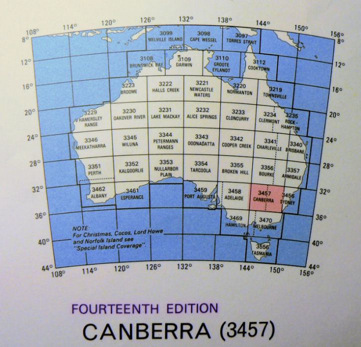

Ross Posted September 10, 2007 Share Posted September 10, 2007 Hi Ben WAC or World Aeronautical Charts are charts (maps) specifically designed for Visual Flight Flying. They have things on them that are important to pilots like the heights of TV towers and mountains and the location of these and aerodromes and major roads, railway lines and out our way wheat silos at railway stations etc etc. Lakes and rivers are easy to see from the air so even if they have no water in them are still very prominent so feature on the charts as well. The charts can be bought treated so that you can write on them and rub the tracks & notes out without permanently marking the map. See the index of all Australian WACharts below. [ATTACH]3590.vB[/ATTACH] The series covers the whole of Australia with each chart covering 6 degrees from East to West and 4 degrees from North to South. Regards Link to comment Share on other sites More sharing options...
