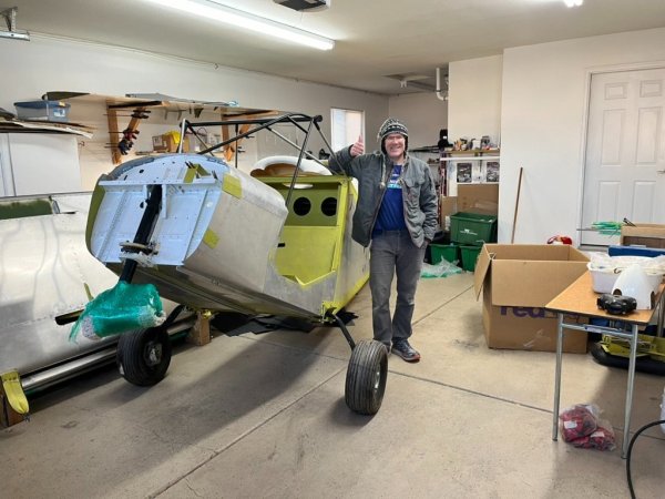

Yeah!  The Savannah VG kit made it home this weekend after 23 hours of driving!  I am sorting through all the parts and everything looks in good shape.  There are no major surprises (yet).
image.thumb.jpeg.2cd54ed7b30de04a941865a321e0c780.jpegimage.thumb.jpeg.a1ee79959a18050fb35a8a7f220897c8.jpeg
I knew going into the sale that there was little hardware with the plane (most of it is already installed) but I need to buy blind rivets and want to make sure I purchase the correct ones.  I searched the forum and did not see specifically where a part number was called out so I thought I would reach out with my question.  I also did not see the part number in the manual other than A3, A4, A5.
