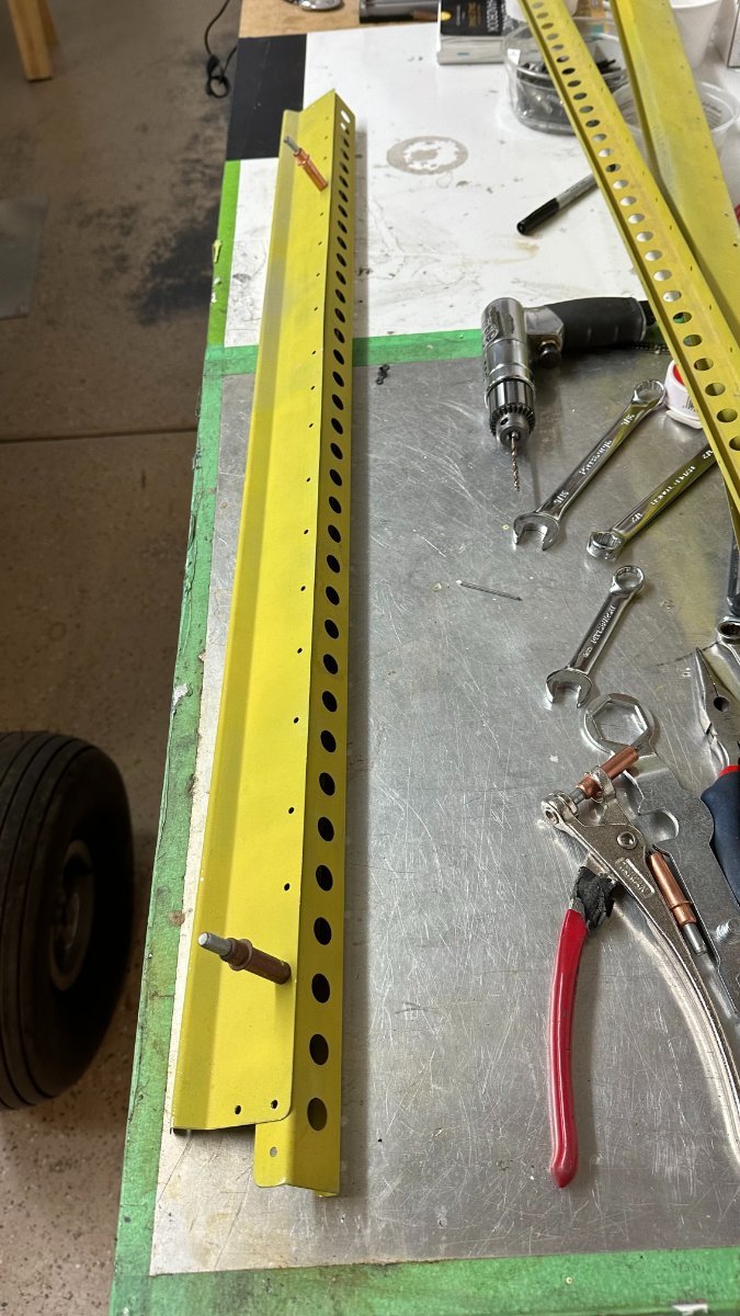

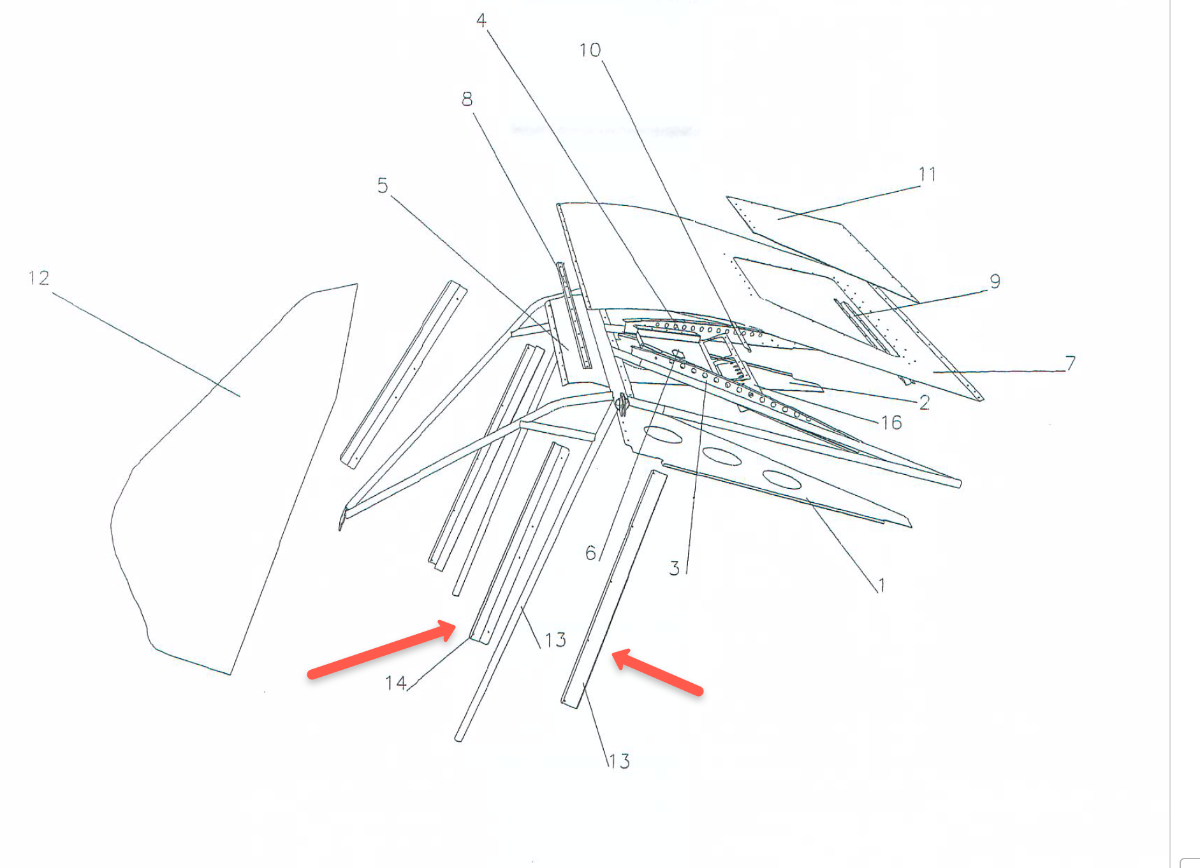

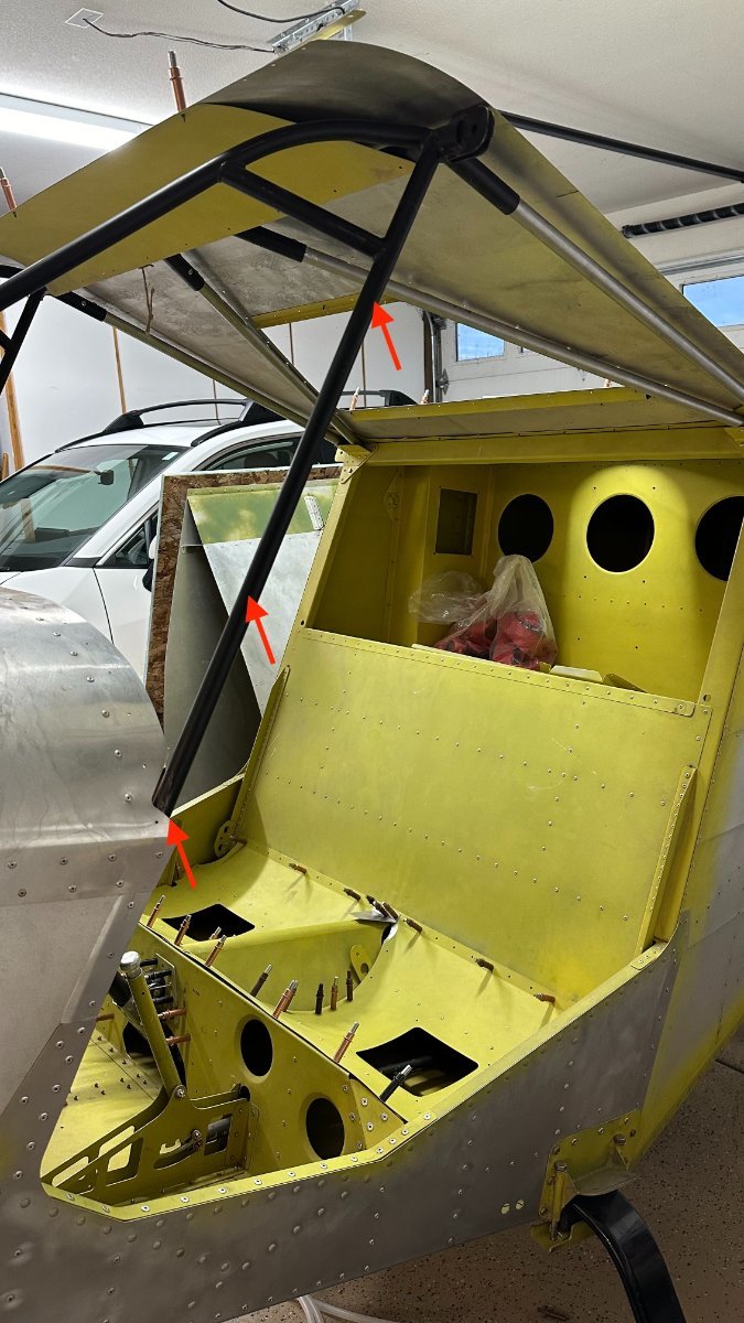

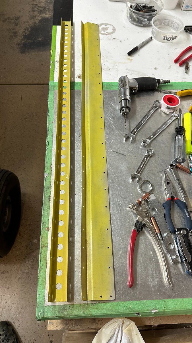

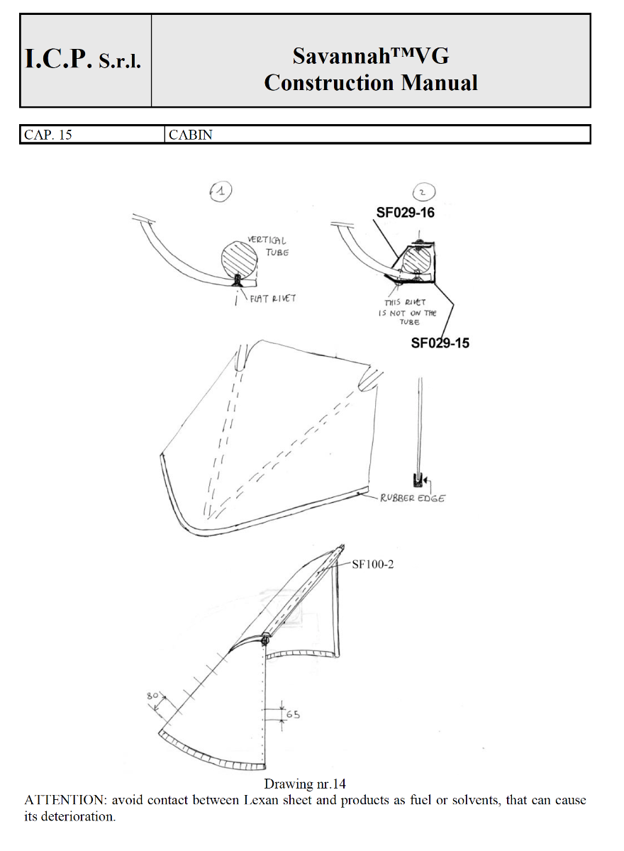

I'm working on finishing up the forward cabin and am somewhat confused with the parts that I have verses what is shown in the VG build manual. I'm guessing I have older parts than what my build manual is showing. I've spent time reviewing other builds to see how these parts go around the vertical tubes. I won't install them until I install the windscreen (after paint) but want to sort out the parts now. Here are a few pictures from the build manual and the parts manual. The p/n's are SF029-16 and SF029-15. Many of my parts have been primed and the part numbers are gone thus the guessing game. I've also posted pictures of what I have and how I think they go together (based on the holes lining up) but I'm still not clear how this captures that windscreen and attached to the vertical. Any pictures you have of a similar vintage would be helpful. E7AD77B5-7513-4F9A-ABD2-5F3DAD16F6E3_1_201_a.heic

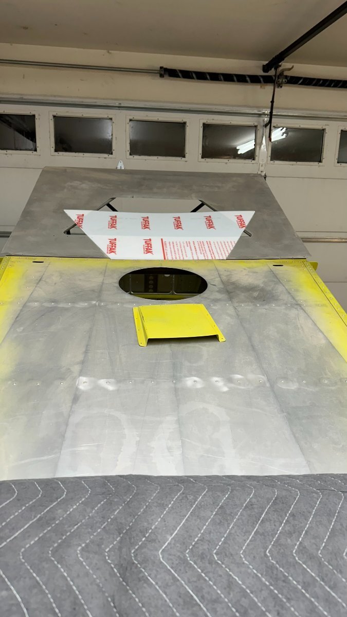

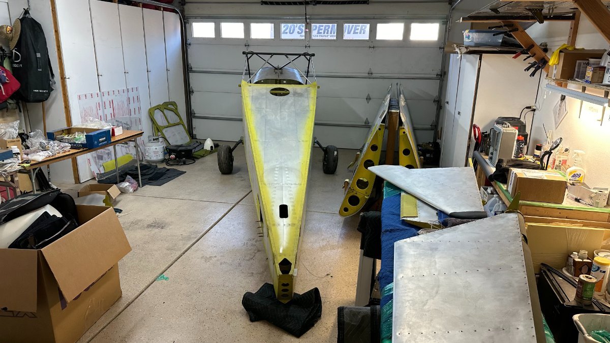

I've started going through each chapter and verifying the work completed thus far on the kit I recently purchased. My kit S/N is 02-10-51-173 so it's over 20 years old and I expect to need some parts that I'm probably missing. The "Air Outlet" on top of the fuselage behind the cabin is a round hole instead of a square. I have the part (sitting behind the hole in the picture) but I'm wondering if my top skin is for the parachute (which I don't have). I'll fabricate a cover and mount the air outlet part I have but I wanted to see if the group could provide any insight as to why this hole is round and not square. Thanks!

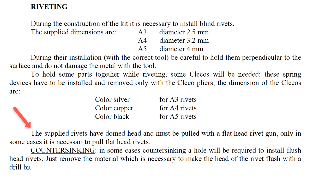

Yeah! The Savannah VG kit made it home this weekend after 23 hours of driving! I am sorting through all the parts and everything looks in good shape. There are no major surprises (yet). I knew going into the sale that there was little hardware with the plane (most of it is already installed) but I need to buy blind rivets and want to make sure I purchase the correct ones. I searched the forum and did not see specifically where a part number was called out so I thought I would reach out with my question. I also did not see the part number in the manual other than A3, A4, A5. I've researched the Zenith forum and know they use a custom mandrel on the rivet gun to make the flush head into a dome head (as mentioned here). The Savannah general construction instructions in the manual states: From the way this reads, they are not using the "Zenair" rivets that dome the head when pulled. I did not get the OEM rivet gun either so I need to buy one. Most of the riveting I did on my Sportsman build were solid rivets with a few pull/blind rivets. Here is what I think the rivets are: https://www.aircraftspruce.com/catalog/hapages/avexblindriv.php?clickkey=680266 Thank you for any guidance! Kyle B4265894-8DB6-427B-AB7A-A4F782B18DCB_1_201_a.heic
