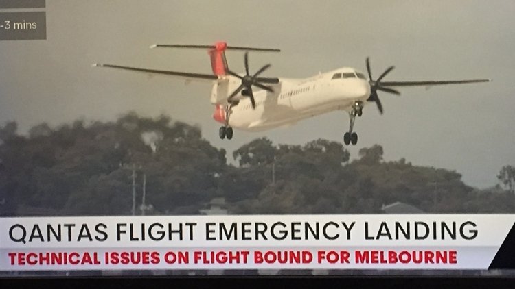

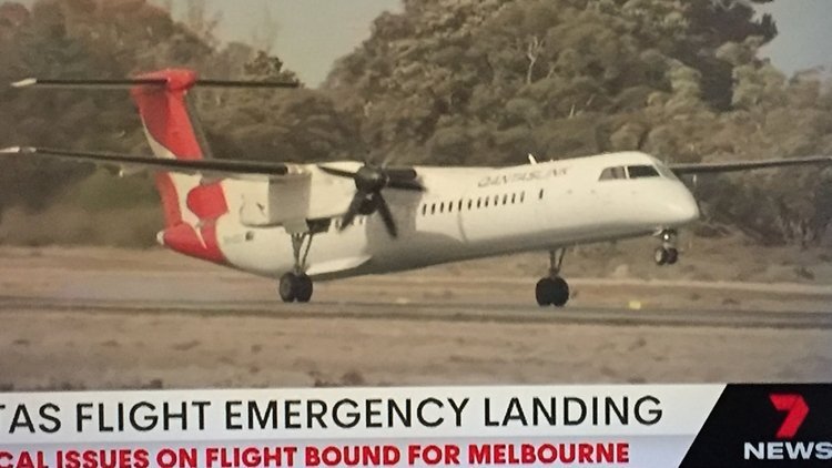

red750 Posted Tuesday at 06:21 AM Posted Tuesday at 06:21 AM A Qantas Q400 took off from Mildura today, and suffered failure of hydraulics in its flaps shortly after. It circled the area for some time to reduce fuel before making an emergency landing without flaps. 3
facthunter Posted Tuesday at 07:02 AM Posted Tuesday at 07:02 AM "Without Flaps" would be dramatically fast (over tire limit speed) with very FLAT approach. There is usually an alternate method of flap extension.. Nev 1
red750 Posted Tuesday at 08:24 AM Author Posted Tuesday at 08:24 AM I'll take your expert advice on that, but there certainly didn't look to be any, and the field was surrouinded with emergency vehicles. .
