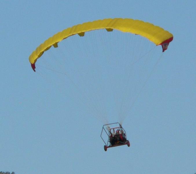

Cosmick Posted November 14, 2008 Share Posted November 14, 2008 Aerochute Controls Hi Thomo, The Parachute is controlled by 4 control wires on each side attached to the Trailing Edge. See pic of my flying away with right hand down. This slows that side of the wing which causes the machine to turn right. Pulling down both toggles at the same time causes the wing to slow down and the machine to Pendulem forward - Flare. See video's on manufacturers website www.aerochute.com.au Hi BLA82, been up in the Echo and Sierra today, Am hoping to take the Aerochute up early tomorrow Saturday say 6 till 7am weather permitting. Link to comment Share on other sites More sharing options...
