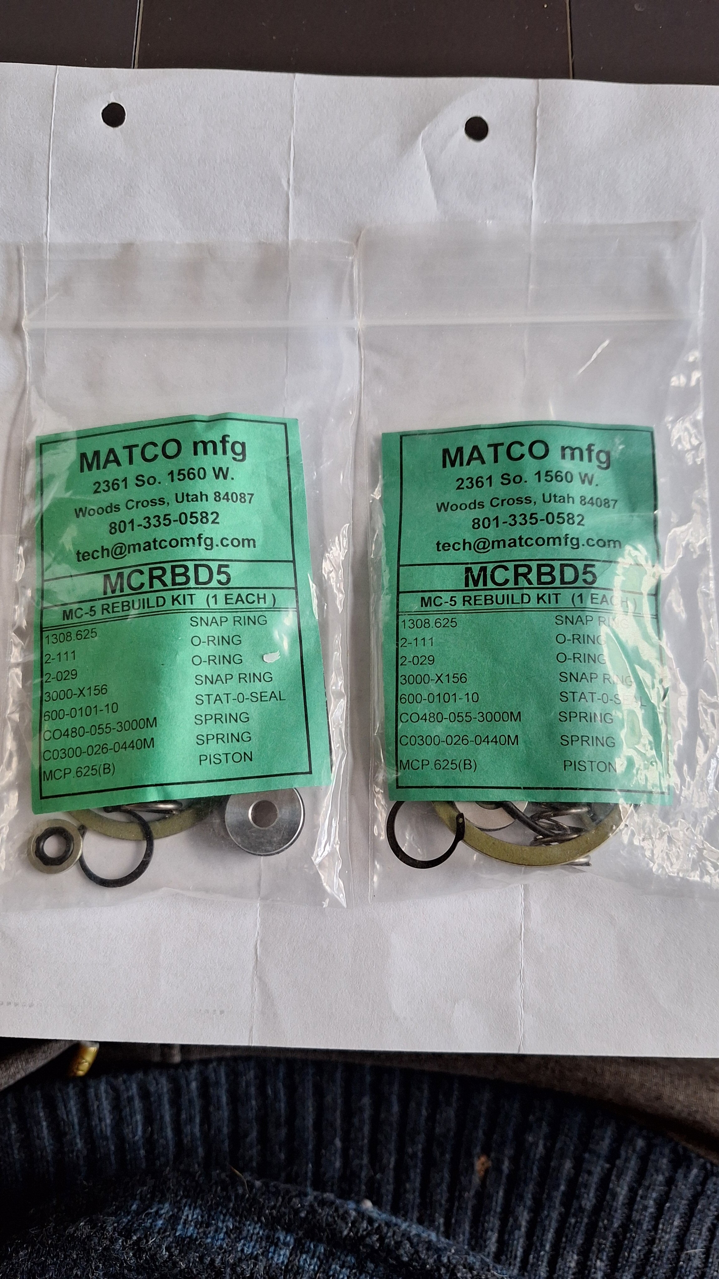

  1. I have two new unopened MATCO MC-5 Brake Rebuild Kits for sale. I ordered the wrong size kits so am selling these at half new retail price (Original invoice will be enclosed with package). See photos for what is in the kits. Postage at cost - message me for a postage quote.

  13. Thanks Superfox and Nev. I have now rebuilt my master cylinders using new 'O' rings from Transeals here in Perth - very helpful. Now working 100%! I have also changed to using Dot 5 silicone purple brake fluid which Matco specify (most L2's use red hydraulic fluid) Yes they are Matco MC-1 master cylinders which I discovered when I ordered 2 x MC-5 rebuild kits from SkyShop which are way too big. So I now have 2x unused/unopened rebuild kits for Matco MC-5 master cylinders to sell cheap! The reason I bought MC-5 is because that is what it says in the Skyfox Gazelle Maintenance and Service Manual. Oh well???
