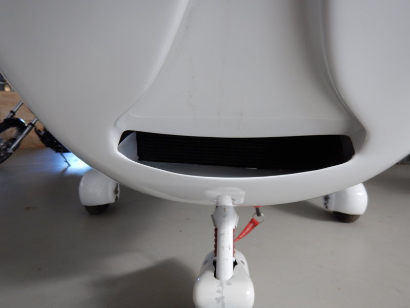

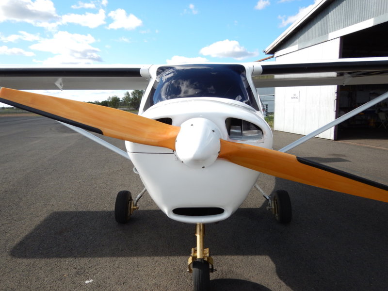

This is interesting stuff Paul, as I am currently investigating what seem to be high oil temps on my Jab courtesy of the oil cooler inlet being a cross between the old and new. Those I have seen with great cooling seemed to have more of a 'scoop' thing going on. I can only hypothesise that this stops the airflow simply running down the face of the cowling below the prop, with only the occasional lucky bit heading into the cooler?? Mine is the first photo and the later version is the second. You can see how the indentation on the second type would at least cause the air hit the lip and go in. Also no rounded lower edge. Ahh, more glassing I suppose....
