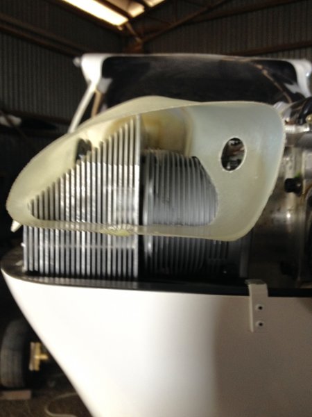

  4. O.K. - sounds like you have achieved nirvana with your temps! If you have an pics, I would be curious, particularly if the top of the engine is totally clear! Thanks Bruce - likewise, your temps are looking really quite good to me with no.4 not being overly outlandish. Bruce - I have read about the cross pieces in the cobra head. Did that actually lower some temps for you? Just went for a lap since that last post and found no. 1 really probably too cold to be flying. With a little defending here and there (power left on as best I could...), it was actually in the 80's and 90's at times!! The temps quoted are straight and level @ 2900. Please don't judge me on duct tape, as the fence was strictly trial only and now to be permanent! It is possible to go too big, as I also trialled a bigger fence which covered the triangular outline of the head and instead it added about 11 degrees to no 2, but did drop the rear cylinder by 10 degrees to 140. (These figures are around 20 degrees ambient BTW) Just trying to find some other pics, but you may be able to gauge somewhat how much the intake has been opened. (I only have a 'before' pic of the left side I'm afraid...)

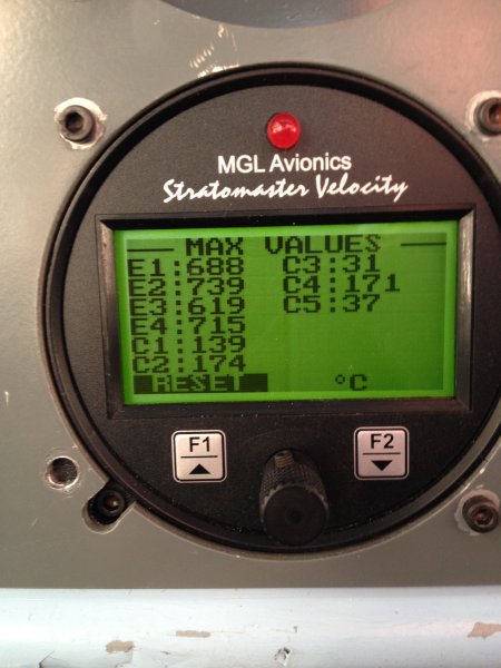

  11. Very early days into the testing, but cruise (not much more than downwind leg so far...) are mid 150's, but max values recorded are in the pic. Note - no 3 CHT not working... Buggered if I know why 2&4 are so much warmer, albeit nicely simiar!

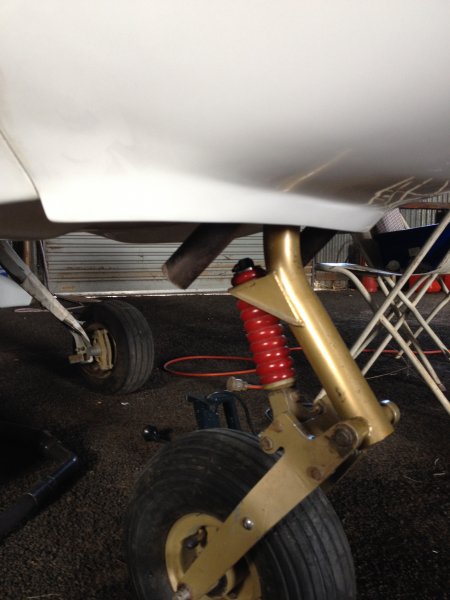

  13. Here's the lip - I think it needs increasing...maybe angled further backwards now? There aren't any fences at the front of the heads, as these earlier ducts only extend down as far as halfway anyway, but thinking I might install some 2cm x 2cm angle pieces there anyway to send the air over the top of the fins/barrels??
  14. Thanks Bob. I had a lip glassed on the lower cowl whilst up at the Jab factory, but I am thinking I'd like another inch or so on it!

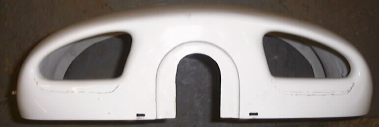

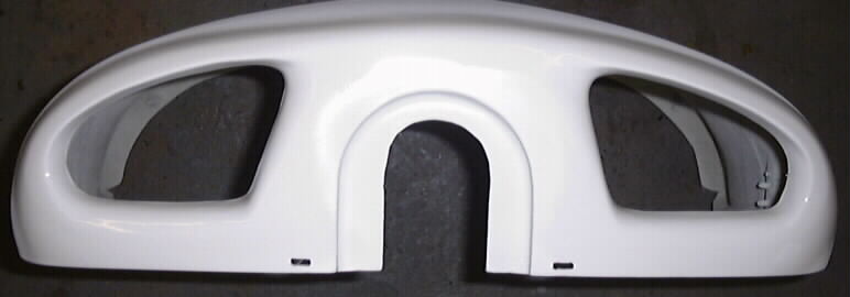

  16. Hi all. Just in the process of playing with the cooling on my newly re-vamped Jab and was wondering how many owners are using the original LSA style top cowl with the smaller front intakes, as well as the earlier plenum chambers / ram air ducts with the plug leads running externally? While I have every intention to open up the front end a little more to match the ducts, I am wondering whether they can do the trick or not, given that I've read a few articles which suggest that they just won't cut the mustard. Apologies in that I know Jab cooling has been done to death, but doesn't seem to be much on the old vs new ducts/cowls and I'm very curious to know who has the early stuff and if so, what was their keys to success!! Cheers, Seb
