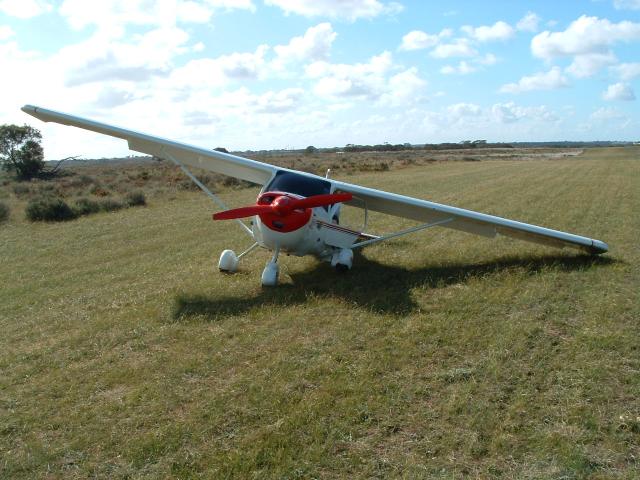

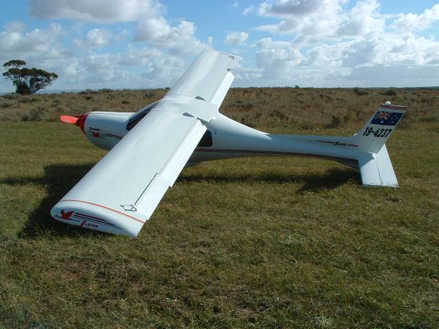

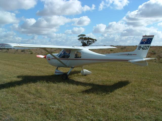

  8. I assume everybody knows about the Jabiru recommendation to upgrade the bolt size from 5/16" to 3/8" on the early Jabiru SK & SP models. I heard about it early last year but was slow to react due to what I thought were logical reasons. When I heard about the bolt size upgrade I removed the rear bolts on my SP 6cyl which had 95 hours on the airframe and inspected them. They were straight and had no stress marks. I also buildt a SK Jab (2nd Jab kit sold) completed May 97, which is now owned by brother . This aircraft had 1500hours on the airframe all with the 5/16" bolts. With this information I decided not to change the bolts. WRONG!!! Late last year I decided to fly to a friends place for some socialising, as he has his own strip and works from home repairing aircraft. When I was in the circuit at his place I noticed the hanger open people and other aircraft. With the wind direction it meant I would be landing in front of and near the hanger, so I thought I better make this a good landing as fellow aviators like to judge and make comments. My landing was a greaser and my friend commented to the other people "thats how you land a Jabiru". After the wheels touched I heard a crack as if a krock had hit the left hand wheel spat. As the plane slowed down I noticed the left hand wing slowly getting lower and just before the plane stopped the wing touched the ground. I immediately knew what had happened, the suspension bolt had brocken. Because the leg was bent right back I had to climb out of the right hand side not easy for a fat old block, especially when it could have been avoided if I had upgraded the bolts. The damage to the aircraft was minimal. A 2" scratch on the left hand wing tip, small scratch on the underside of the elevator, demolished wheel spat and brocken/bent suspension bolts. We lifted the wing on to the roof af a station wagon my friend had some new bolts which we fitted. With the help of my Level 2 friend we thoroughly inspected the Aircraft but found nothing wrong structurally wrong. I threw all the brocken fibre glass bits in the back had a coup of coffee and flew home . The following week I ordered 2 sets of 3/8" bolts from Jabiru and replaced the bolts in my brothers SK as well. [ATTACH]2405[/ATTACH] [ATTACH]2406[/ATTACH] [ATTACH]2407[/ATTACH]
