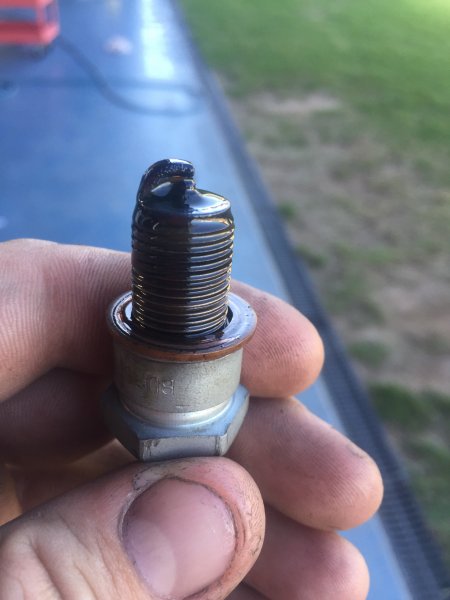

Update today: On both plugs, #5 cylinder. Not a lot of sparking going on there. Cleaning away the liquid oil revealed a burnt "bridge" of oil. -

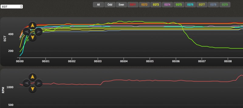

I do actually have a whole bunch of info tucked away in a manual about EGT/CHT diagnosis. Might be reading that properly soon, although in this case I know what was indicated and what it meant, but mysteriously talked myself out of believing it. I certainly believed it a couple of minutes later, I can tell you! -
