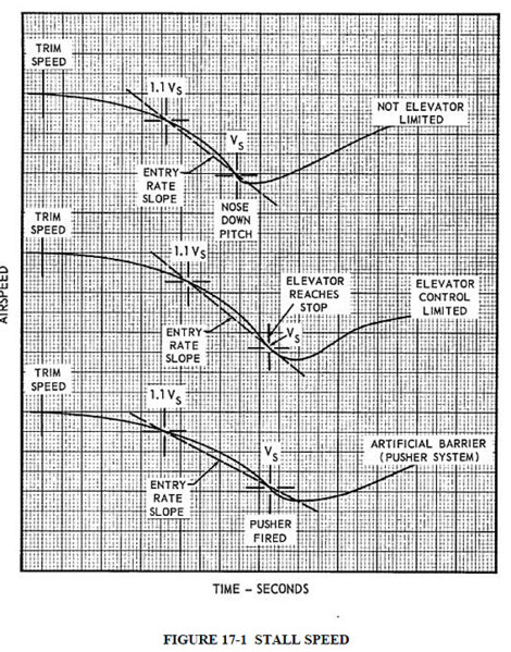

The 2Q head substitutes for both the pitot and the static sources, and it does so with very little tubing, especially if one uses a differential pressure transducer instead of a mechanical ASI. Attached is what it looks like, and the calibration curve for the one Jabiru use. A trailing static is not as suitable for stall speed testing, because if the aircraft is descending, it suffers from "lag balance" - the change in static pressure due to changing altitude creates an error, which can be quite large. This is due to the time it takes to fill the tube and the instrument case, which can be considerable for a trailing-cone static. Note: Systems such as the Dynon use a differential pressure transducer - but for certification testing, it needs to be calibrated immediately before and immediately after each test flight. If I'm using the 2-Q head with an ASI instrument, I usually cross-calibrate it against a trailing-cone static and pivoting-vane pitot, in level flight, just as a double-check. Jabiru_probe_calibration_2004.doc Jabiru_probe_calibration_2004.doc Jabiru_probe_calibration_2004.doc -
