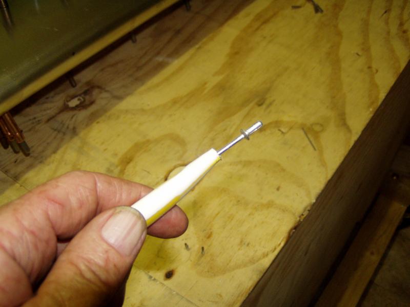

    Hi All, Another idea that I thought I might share. With something like 10 000 rivets to put into a Savannah, there are more than a few that are a little difficult to line up. This little tool has saved me sore fingers and eliminated the risk of piercing my hand with the sharp end of the rivet.[ATTACH]7375.vB[/ATTACH] Just cut the head off a soft-handled toothbrush and drill a hole in the end to take the full length of the rivet shaft. It is soft on the hands and releases the rivet easily.
