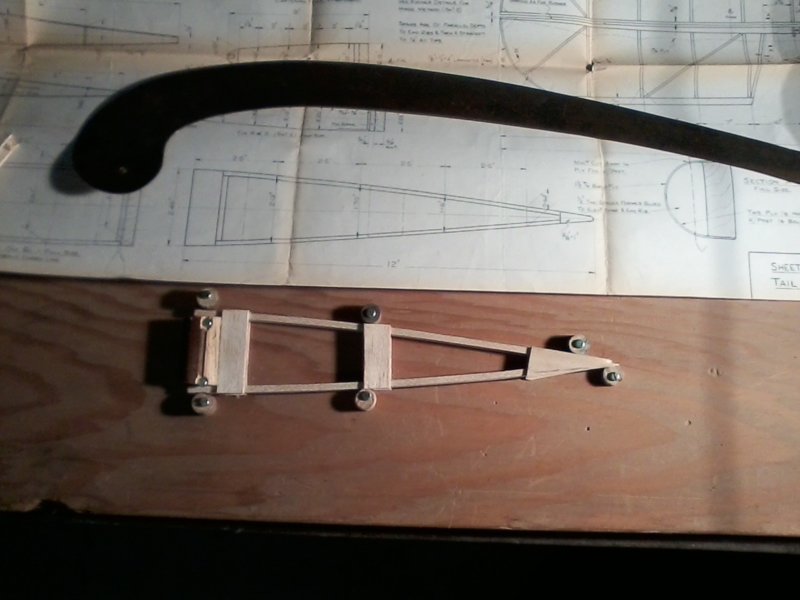

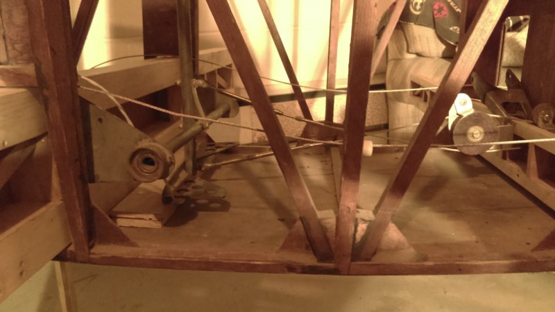

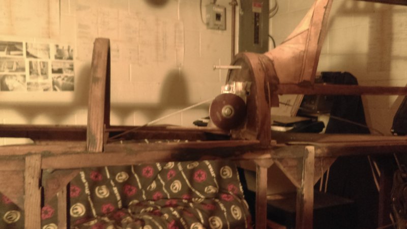

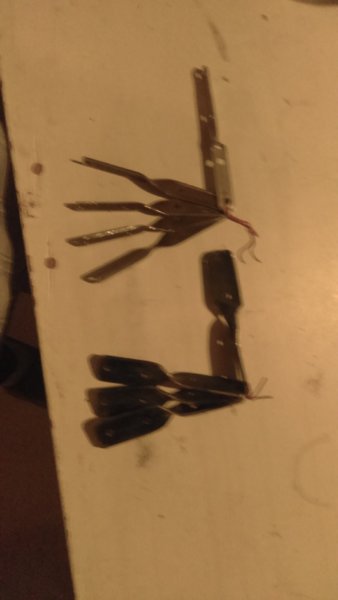

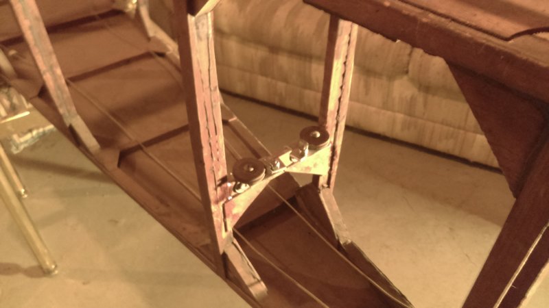

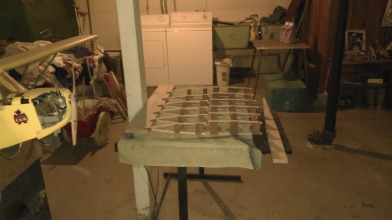

I have been working on the rudder cables and elevator here is some pictures of the pulleys I have built in. one picture is of the KR-2 hinges mounted to the rudder and also a picture on the elevator cable layout under seat. Its all a work in progress. more later -

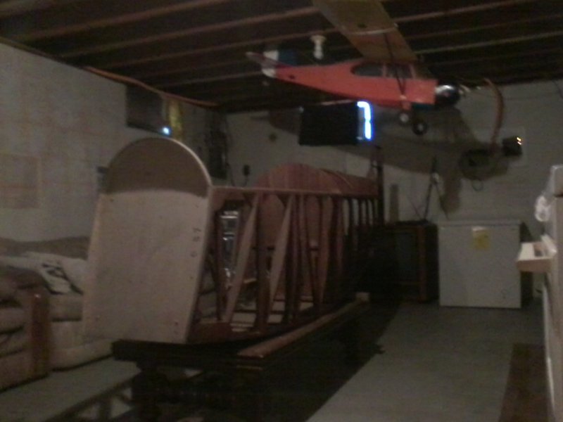

Just want every one to know I'am building a Taylor in the upper midwest of USA and I think the only one being built at this time in the states. Here is a few pictures. If any one has built one and want to share ideas please contact me. Don

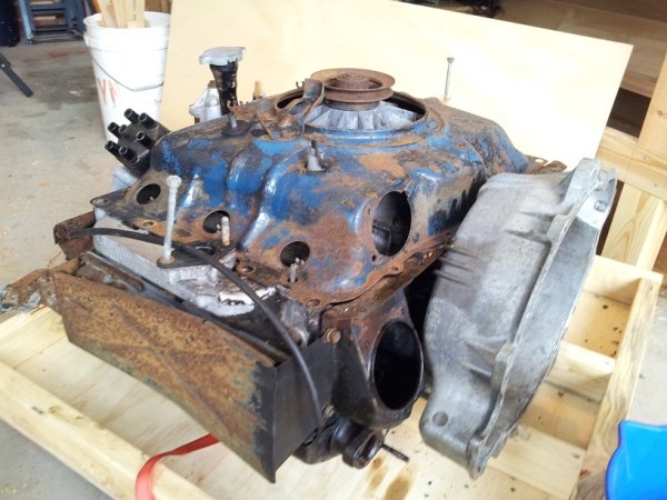

Looks like you got your self a Corvair. Is it the 145 cubic inch or the 164 cubic inch? I have a aircraft conversion build book from William Wynn one of the corvair authority in the USA. I have a bellhousing cut down and ready if you need one but depends on if your running the 5th bearing or not. I built a 164 ci for my KR-2.

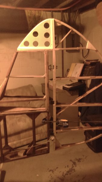

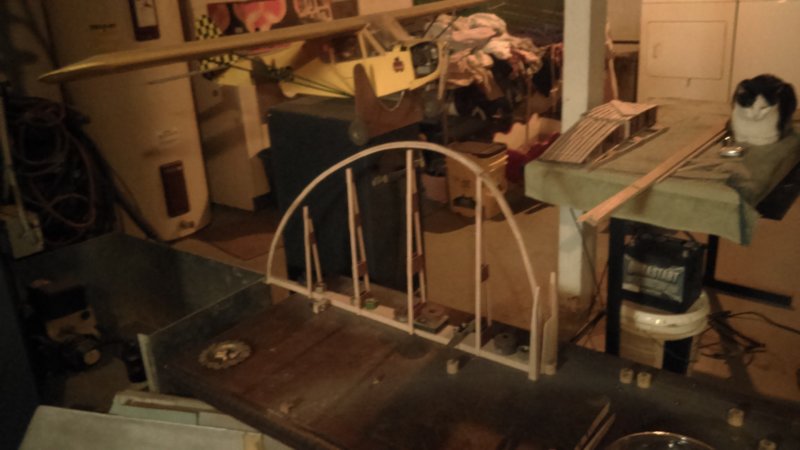

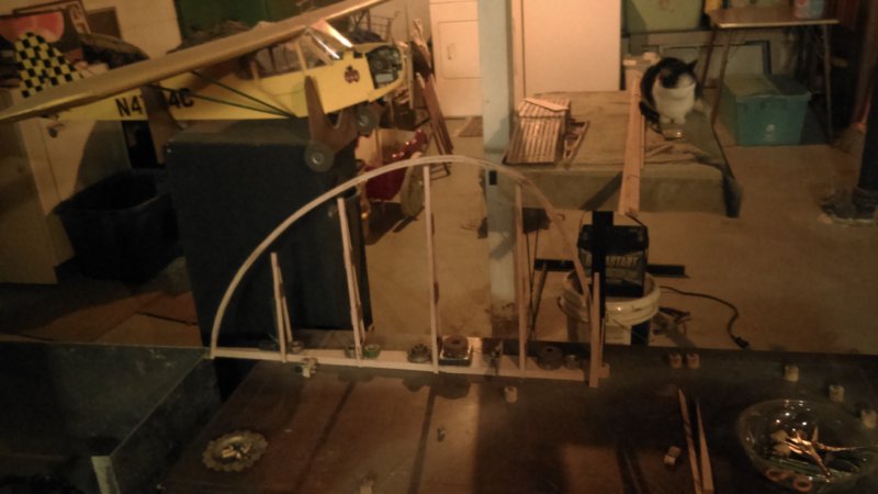

got a bit closer with the rudder last night. I like the curve and lines of the Taylor- mono tail feathers. -

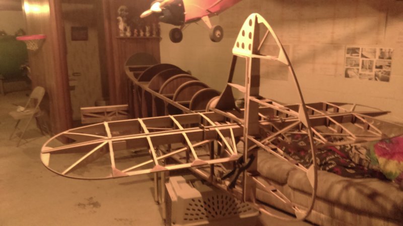

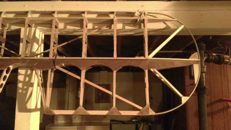

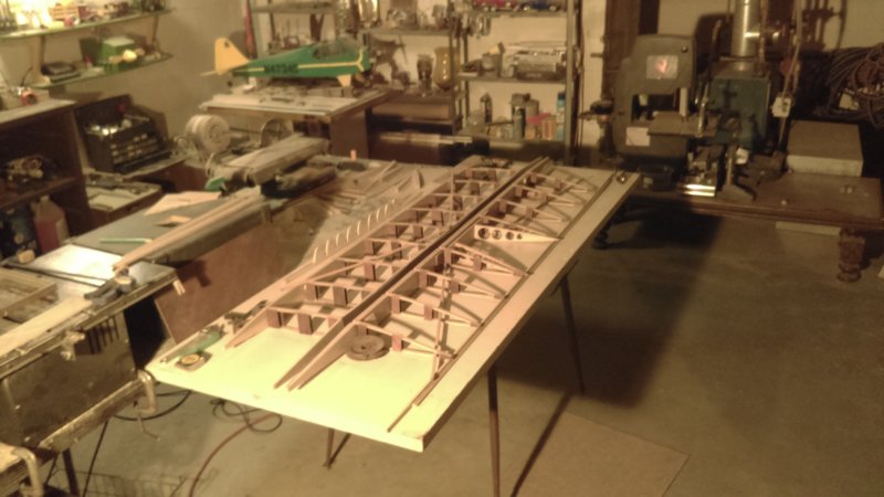

I will Roger. I'm just finishing my ribs for the Elevator and Horz. Stab and rudder. Doing the shaping of the Spars and getting hinges off my retired KR-2 cleaned up for mounting. I have some pictures posted on the HomeBuiltAirplane forum. I have a cowling for a Soneria that I hope to make fit the T-mono. I haven't figured out how to post pictures yet on this forum but will check into it.On the HBA forum I can go to my pictures on the PC and download to the site and I'am sure its the same way here but I only get asked for the image URL and mine are JPEG I guess I need to use a photo bucket?? Love your plane. Don -
