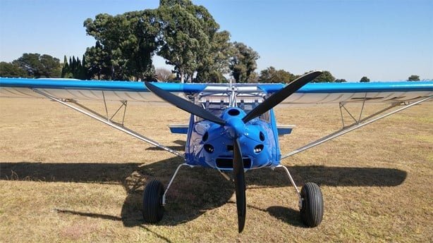

    What  sort of aircraft did you say all this is going in?
    I shudder to think what convoluted, hard to bleed, plumbing is required - how about some photos???
    Was KISS part of the design philosophy?
    If it works as you expect then all good.
    I thought you mentioned a high wing STOL - not something that tight cowling, is usually associated with.
    High performance WW2 aircarft with huge engines, in very tight cowlings, often had remote heat exchangers (under fuse, in/under wings, etc) - is your baby in this company?😈
    I bought a kit, not based on 'oh, this has one too many oil coolers in it', but rather on it looking like it would be a fun plane to build. Any technical questions, you will really have to ask them. It is a Skyreach Bushcat. There are many KISS principles at play in this design, for instance TRIM and FLAPS are totally mechanical, not electric. No auto pilot. I selected a carby engine. And a single piece wooden propeller (although it turned out to be the wrong pitch, so maybe SOME complexity, ie ground adjustable, could have been handy)  If one wanted to totally keep to the KISS principle, one would buy a hang glider.
    Attached, a good frontal picture of someones Bushcat, for your edification. Visible are the radiator, above it the first oil cooler and above the spinner the second oil cooler 😇

  2. Yeah, it's a funky design. Instead of one larger oil cooler, theres two smaller ones. The top one is in and out, which i.guess has the advantage of none of that hot air going over the engine. More likely it's designed that way to make the engine cowl quite a tight fitting affair. Witness for instance where oil coolers end up on WW2 aircraft 😇

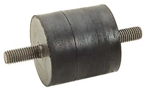

  3. 52 minutes ago, IBob said:
    ICP use the bobbin type shock mounts, top and bottom. But they can separate: I replaced one recently but I think it was originally mounted in a stressed (not straight) manner.
    My top oil cooler is mounted with these on the top of the engine. The bottom oil cooler and the radiator are just mounted directly to the bottom cowl.
