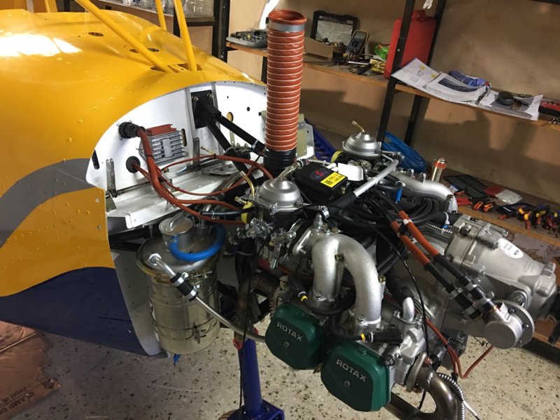

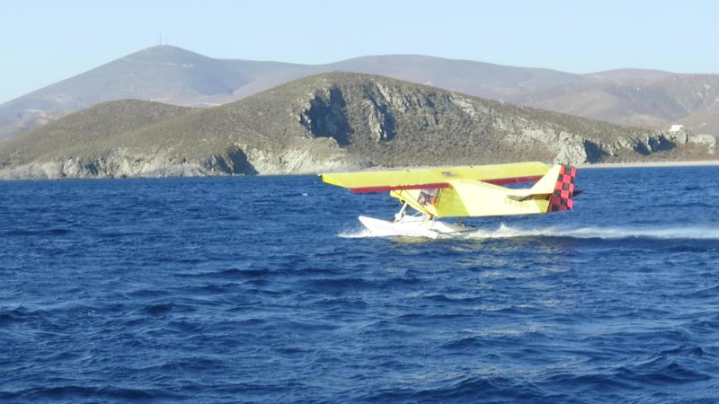

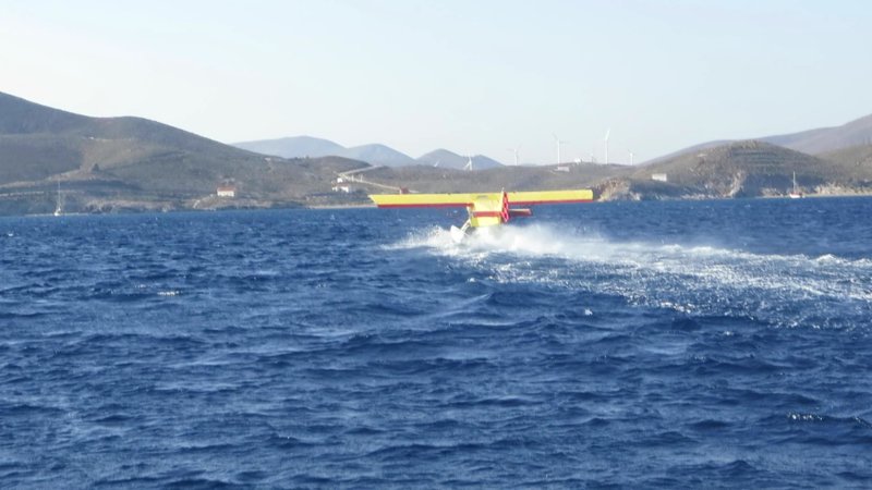

  15. Hello to the team I have to say that. An ultralight without a parachute is like a Russian Roulette. I am here right now and I am writing because of the BRS parachute installed on my Savannah............... Is a big surprise to me that after lot of bla bla bla was only few words about parachute back on 2011............. With law or without law before even you do the first engine start, parachute must installed. In Europe almost all ULM has parachute. I started to dive with my friend from 500 ft (maybe less) because we lost the elevator at base leg of approach and we survive without any scratch and minor damage at aircraft. From the time that problem appears until touchdown was less than 8 sec....All of them back at 2004. It is the most bigger innovation at aviation. If someone interested I have the manuals for parachute installetion on Savannah S. Are 9mb and doesn't allow me to to upload here. Yiannis

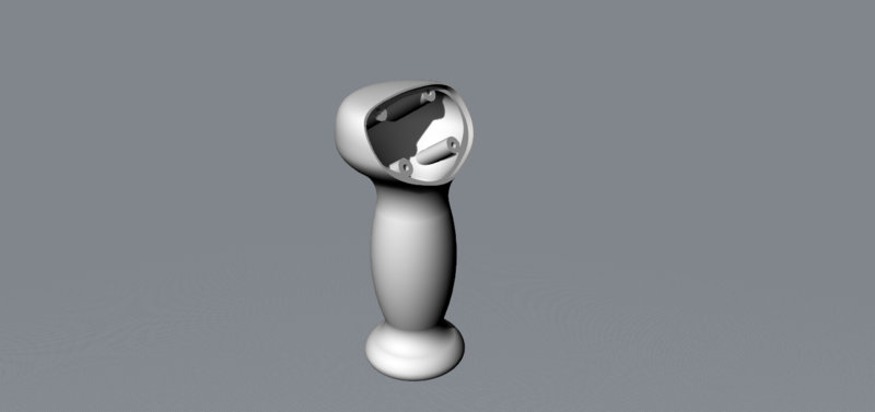

  20. TIPS This is the handle (grip) that I am working now.

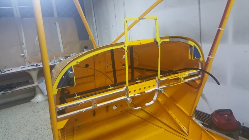

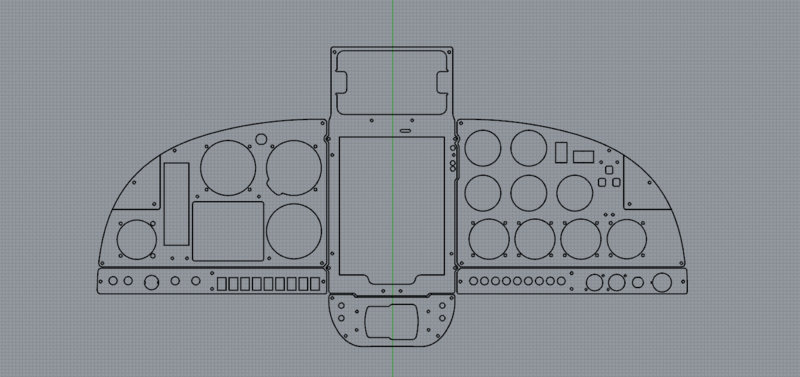

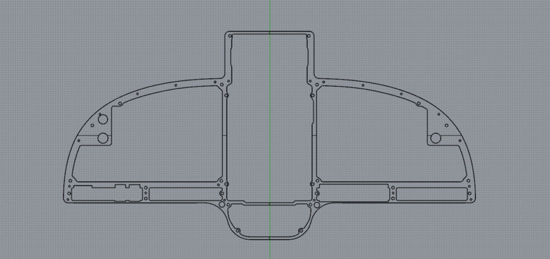

  21. OK let's start from the idea. I thing that the Savannah S panel is really ugly... I believe the reason is because of throttle rods and the bottom of the panel is a part of fuselage structure. I needed lot more of switches and breakers from those that the kit provide. Also I added some additional instruments and all of those needed extra space So I divide the panel at 6 separate panels. Two main for instruments, one central for big tablet and the Garmin 469 under the hood, two panel for switches and breakers and one small at the bottom of central panel for cameras live view, intercom plugs and three gimbals control (at one axis only). In additional, my plan was the tablet to look like part of the panel and not something that was add last moment additional. In order to do that I move all the new panel 15mm ahead of main frame. The main frame is that the ICP provide and I added the tablet behind my new panel. With this arrangement I added more strength at all panel frame. plus an square rod 200 mm behind the panel assisting on this. I am using this square rod also as a cable trice. I remove a lot of metal from existing frame and I was filed uncomfortable. In order all of those to be happen I needed a total new panel design. I started to work on CAD program (I learned the Rhino 5 just for this....) and I added at my work shop a 3d printer. I did a lot of experiment for how I will arrange all of those without losing the strength that the original frame giving to fuselage. So the final cutout from main frame was as per photo 1 and the additional frame designed from me is at the photo 2. At photo 3 you can see how are the 6 instrument panels. I know the questions will be a lot. I will try to answer all of them and off course it will be my pleasure to assist anyone that he like to make something similar. I hope my English to be OK and understandable. Yiannis
