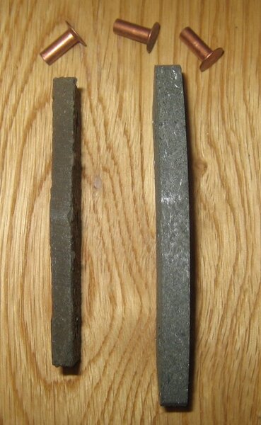

diablo Posted April 22, 2011 Share Posted April 22, 2011 I recently fitted new generic pads on my SK and braking is very impressive. The pads should fit the older jabiru's ( SK, J, SP and UL types) with the old brake assy. They are available from www.partsforaircraft.co.uk. Price is competitive. See attached images, it's amazing the difference that better materials and design can make (originals are darker and without form!) ... Link to comment Share on other sites More sharing options...
