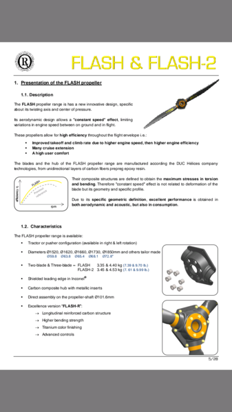

JUSTNUZZA Posted June 20, 2014 Author Share Posted June 20, 2014 The only real benefit of the C/S prop that I had was a slightly shorter take off roll and a steeper approach angle because of the prop being in full fine. Only used to get 118 IAS 5200 rpm at 2000ft and 1200 ft min climb at 2o litres an hour. Now 125 IAS 5200 rpm at 2000 ft and 1000 ft min climb at 19.5 litres an hour. The prop is quite unusual in that it decreases the engine RPM from static to dynamic by about 200 rpm (i.e. start take off roll 5200 rpm and by the time you rotate the RPM is 5000 RPM). Link to comment Share on other sites More sharing options...
facthunter Posted June 20, 2014 Share Posted June 20, 2014 There's obviously something wrong with your C/S prop. At your cruise speeds you are getting into the area of real benefit. I don't understand why you would get less prop revs when you have forward (flying) speed. with no pitch change. Nev Link to comment Share on other sites More sharing options...
JUSTNUZZA Posted June 20, 2014 Author Share Posted June 20, 2014 There was something wrong it was a Woodcomp SR-3000, no end of trouble with burnt out electric pitch motors and C/S controllers. Have not heard any good reports about them. As for the RPM drop with the DUC I guess it is to do with their constant speed effect claims. Link to comment Share on other sites More sharing options...
facthunter Posted June 20, 2014 Share Posted June 20, 2014 There are 2 forces on a prop trying to alter the pitch. One, the Aerodynamic Turning Moment tries to coarsen it. The centrifugal one fines it off as the revs increase Nev Link to comment Share on other sites More sharing options...
JUSTNUZZA Posted June 20, 2014 Author Share Posted June 20, 2014 From the operating manual. Link to comment Share on other sites More sharing options...
JUSTNUZZA Posted June 20, 2014 Author Share Posted June 20, 2014 From the operating manual.[ATTACH=full]30892[/ATTACH] Sorry, did not upload very clearly. Link to comment Share on other sites More sharing options...
