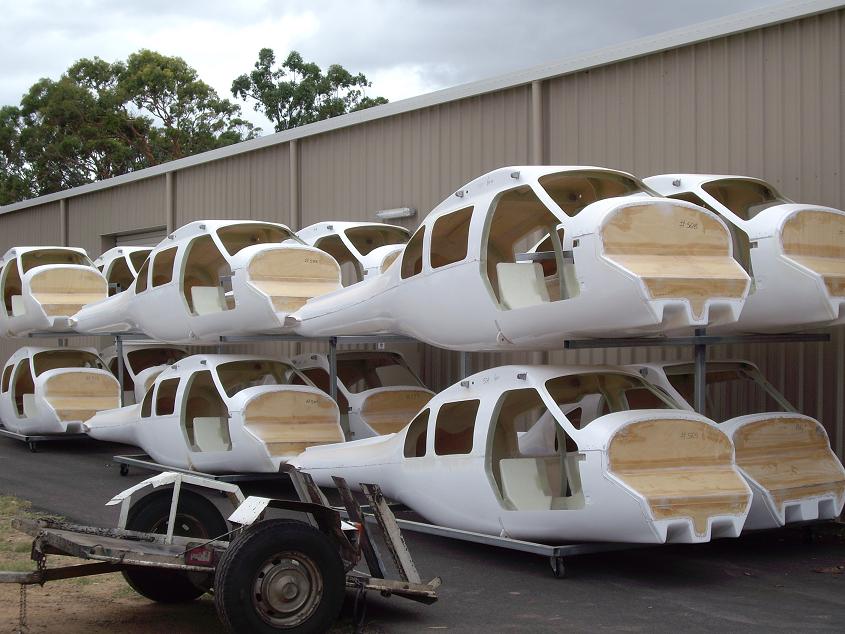

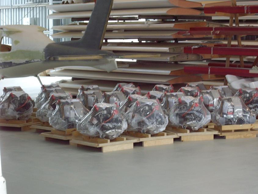

Guest brentc Posted December 22, 2007 Share Posted December 22, 2007 I spoke to Rod Stiff about props at my factory visit a couple of days ago. As I understand it, nobody out there that he is in contact with is able to produce carbon props for him in the bulk that is required (eg 35+ per month) and using technology that will not have the prop tearing apart when they test it. My carbon prop would be great, but the manufacturer wasn't able to produce enough of them in the timeframe required. Rod showed me that he is working on his own prop, however technology (build type )and time appear to be problem areas. Whilst it would be easy to say, 'just get the Sensinich' ones from the US of A, this does nothing towards the local economy and maintaining the building of an Australian built aircraft. Link to comment Share on other sites More sharing options...
facthunter Posted December 22, 2007 Share Posted December 22, 2007 Australian-built. Brentc, whilst the outstanding characteristic of the Jabiru is the quite remarkable fact that the design and production of the entire aircraft is done in Oz. The firm rightly deserve credit for their achievement. HOWEVER (that word again), The aircraft is exported to many countries, and has to compete in those markets, and here. Some components are not made in Australia. eg Electrical, (I would suggest,) & the alloy steels (Billet) for the cylinders and the crankshafts, are no longer produced in australia, and are probably sourced from Brazil. I don't pose this as a criticism, merely an acceptance of reality. The matching of a certified engine/prop. takes some effort. If this was DONE (by anyone), then the Jabs would be better for it. Until then, wood is the go. This no doubt limits the application of the engines, for some people. Nev.. Link to comment Share on other sites More sharing options...
