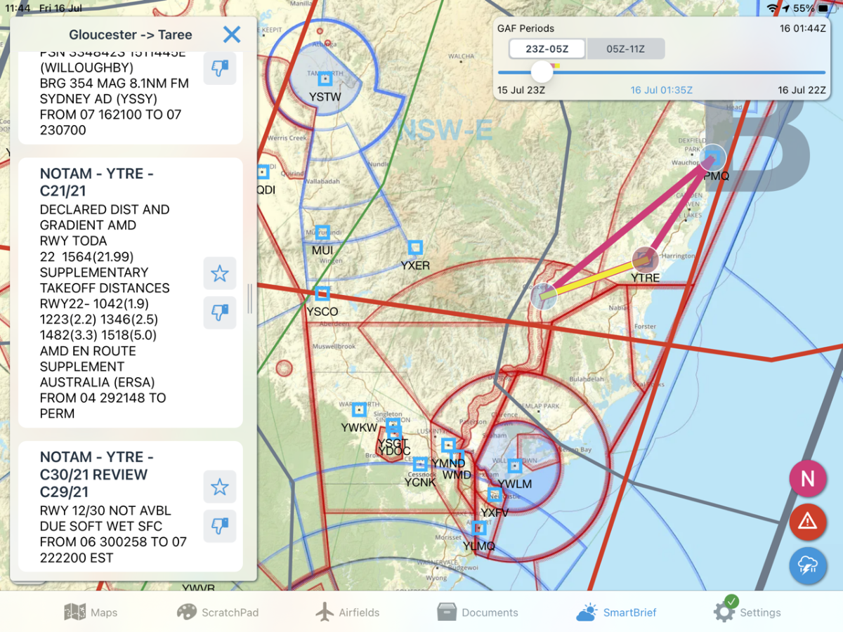

 I’m curious about how and by-whom NOTAMS get selected/ordered? Is there a way around having to wade through tons of dross to get to the morsels that matter. For example, in this little (test) plan [Screen Shot below]  I was interested to see if the NOTAM about the grass strip at Taree being unavailable, due soft and wet, would turn up. I reckon that this would be, perhaps, the most important piece of info for anyone flying in who didn’t otherwise know that.  Well yes, it does turn up (see screenshot) but right at the bottom of the very long list - at #58 in this particular instance. I notice there are star and thumbs down buttons for each entry, maybe these could help but how do they work? (I’m probably missing some good info somewhere.)
Click to see full rez:

".... the thumbs down and star buttons were our way of allowing the user to sort their NOTAMs from most important (starred), unread (blue dot shown on the left hand side), read (no indicators), to unimportant (thumbs down icon).
This is because NOTAMs are very poorly sorted by the authorities (currently under a big review by CASA) and we are not given geographical information to link them more logically for users.
The NOTAM grading system is explained in our User Guide here:
https://docs.ozrunways.com/ozrunways/4a_brief-smartbrief-page.html#...
But essentially star any NOTAMs that are important, and thumbs down any that are irrelevant to you (keeping in mind possible future flights). Then the next time you come to read the NOTAMs, they will be sorted in the order I described above."
