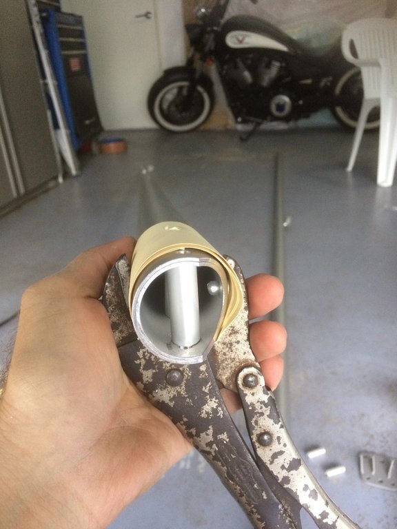

Detail of section 8.2
there are bushes that go inside the bottom tubes where the tail wheel spring mounts. These are a tight fit so what I did was wrap the tube in thin card and then get some vice grips. I wound the vice grips up to just touch the card. And then just enough more to just compress the tube. Not enough to even see. Then I placed the bushes in place with pointy nosed pliers and put the bolts in to hold them in place. When the vice grips were released the tube springs back into shape and holds the bushes ?
Note in in the background is my bike. By strange coincidence it shares much the same specs as the Bushcat- 100hp, 305kg (yep he’s heavy!) and about 180 km/h top speed! Mind you, you don’t want to be going top speed on a cruiser for any length of time, while you could do it all day in the Bushcat ?
