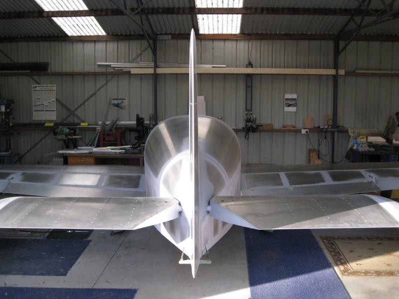

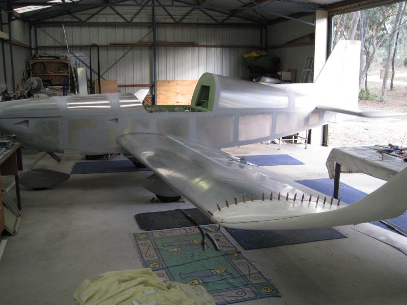

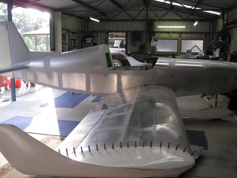

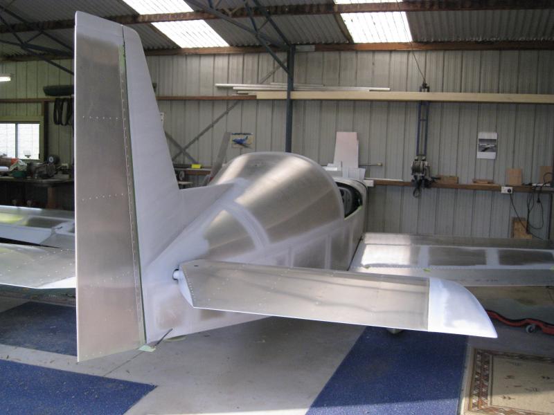

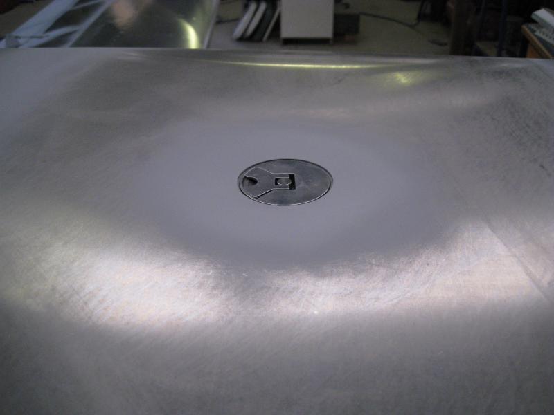

Guest davehw Posted February 3, 2011 Share Posted February 3, 2011 Kevin, Some up to date photos attached of Sierra 100 build at the moment. Flaps to be finished yet. wings need removing and inverting for walkway installations, canopy to be finalized, upholstery & paint required. cheers Dave. Link to comment Share on other sites More sharing options...

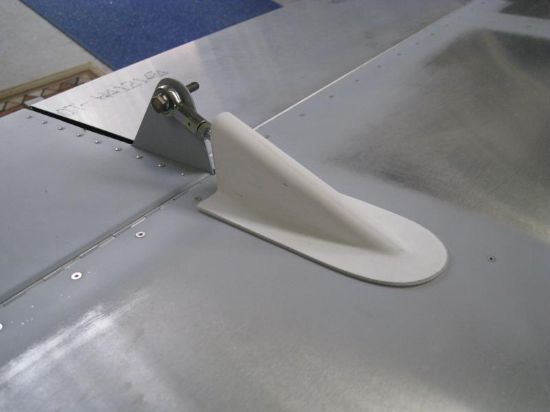

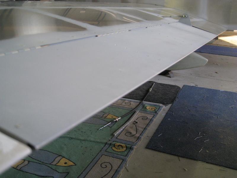

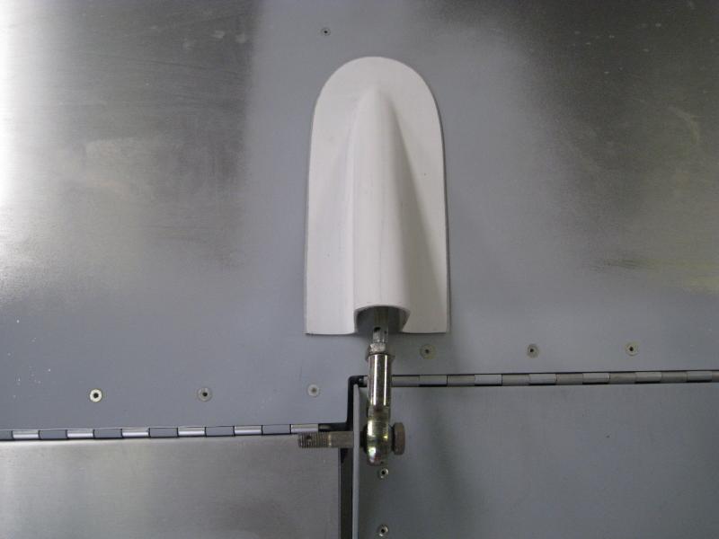

kgwilson Posted February 4, 2011 Share Posted February 4, 2011 Dave, Thanks for posting these progress photos. The build looks superb. The flush fuel cap & oil filler cap are also very nice touches. I notice that you have the aileron control mounted on the top of the wing. Garry's are underneath the wing and he has balance horns to help keep the controls light. Is there any particular or performance reason for this difference? Cheers Kevin Link to comment Share on other sites More sharing options...
Guest davehw Posted February 4, 2011 Share Posted February 4, 2011 I thought you guys would notice a difference with aileron control. We have re-designed the dual control system which required output at top for correct travel direction & differential ( up travel greater than down) which was not achiveable originally. Balance arm remains standard. ..Dave. Link to comment Share on other sites More sharing options...
kgwilson Posted February 4, 2011 Share Posted February 4, 2011 The only issue I can see is water getting when on the ground in the rain. I presume you have that covered though. Kevin Link to comment Share on other sites More sharing options...
Guest davehw Posted February 5, 2011 Share Posted February 5, 2011 Hi Kevin, Have fairings made for the location. Will put them on later, see photos. Have you also noticed ailerons and flaps are made from a single sheet, to give a stonger and cleaner trailing edge. cheers, Dave. Link to comment Share on other sites More sharing options...
