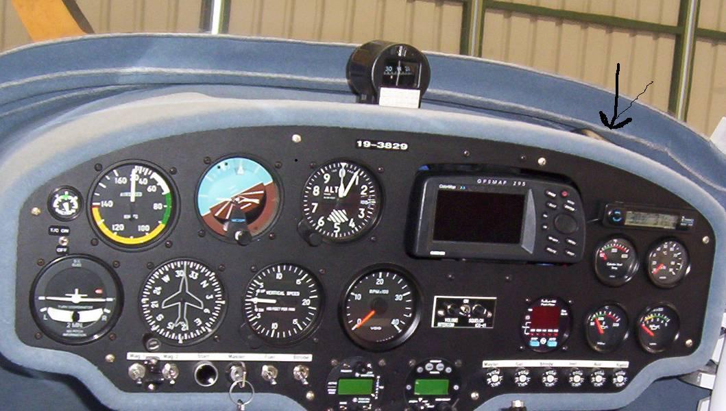

I note that it looks like that dash has the GPS antenna on the outside. Is that what it is up front behind the screen?
????? 1 - If so, does anyone know whether GPS signals have any trouble thru vinyl .... as it has noworries with fibreglass & perpex so I was going tomount mine inside the panel just under the glass. If nobody knows I'll have to do a test later this week.
????? 2 - Also does anyone know whether there is any problem mounting a UHF antenna below the aircraft, behind and within 150 mm or so of the transponder antenna ?????

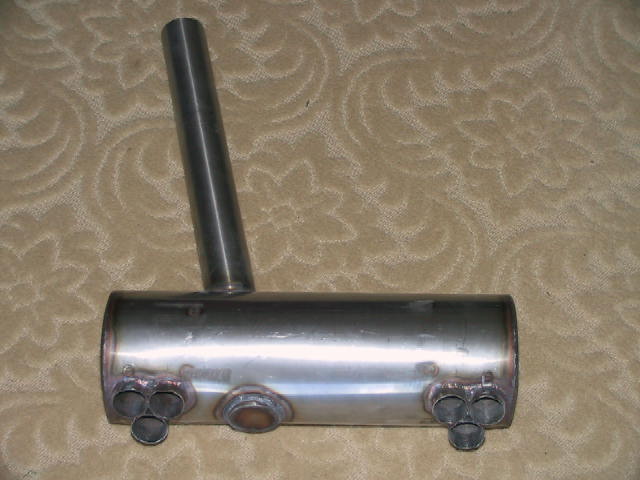

Muffler & final pipe have been sent off to Jet-Hot Coatings for ceramic coating in an attempt to reduce the temp inside the cowl .... but have decided not to unbolt & send off the 6 headers although their surface area is probably greater.
Will post a before & after shot when I get it back in a week or so for those that might be interested in this. Ian McPhee tells me that it made a big difference to his aircraft.

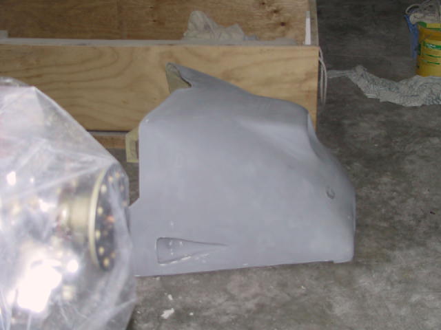

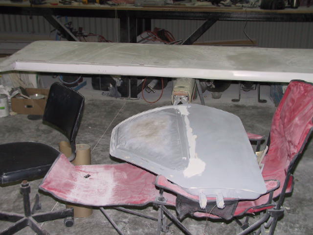

Doors and other minor fibreglass items have been undercoated and have had an initial rub back.
As you can see from those pics .... I also have a wing up ready to start work on it, so that's another little milestone.

Peter ... Why didn't you put your GPS antennainside the panel?
Best regards Geoff
Captain
Have just done a test to try to answer my own question on GPS antenna location .... as I have the same antenna in a Sailplane with the unit mounted inside a carbon-fibre instrument panel under a plastic top and it works well.
I set up the Avmap antenna and recorded the SPS signal strength, then covered the antenna with 3 layers of vinyl and 2 layers of fibreglass. The signal strengths dropped less than 1 point and as you would know they vary all the time anyway.
So my conclusion is that the antenna can go inside the panel out of the directsunlight and it should work fine.

Turtle's panel doesn't seem to have much room left on it. Mine is strictly VFR but I would like to install an electric compass and a 295 or a 296 but that rapidly escalates the cost.

Just a couple of thoughts on panel layout as i see it.
The main problem with the layout as pictured is the location of the transponder and radio.
If in controlled airspace where you have a fair bit of radio work it is allmost impossible to see the frequencies without sticking your held down.
Not a problem if you have a passenger to hold the stick but a pain in the proverbial trying to hold altitude & heading and see the radio.
Other than that fine
Doing it again the radio & transponder would be on top of the GPS.
The GPS can easily be angled for a better view.
You are spot-on Peter. That was pointed out to me by another illustrious member of this forum, and that's why I located my radio & transponder at the top.
Ross ... just tell her those items are each $50 on special at Aircraft Spruce and go for it. That's what the rest of us do. Some of us having beengetting away withthat for years with our toys ... and it's not really a lie when you have your fingers crossed and get her some flowers or something of equal value to your purchase ($50). Captain
I would agree whole heartedly. When flying the Griffith factory built Jabwith the radio at the bottom of the panel it is a real pain keeping track of the frequencies with your head down, not a good idea, and changing them. Howeverthey could all be preset in memory for a particular trip requiring just a flick of the switch to get to the next required frequency.
Some radioscan have a remote button on the stick to cycle the preset frequencies. I haven't checked to see if this is available on my Jabiru supplied radio.
As turtle points out ithe radiois probably, even for VFR pilots once airborne, the most adjusted instrument on the panel. So it does not make ense for it to be mounted at the bottom of the panel. I have moved mine up a bit and if it is not OK then I will cut another hole and make a patch to fill the gap.

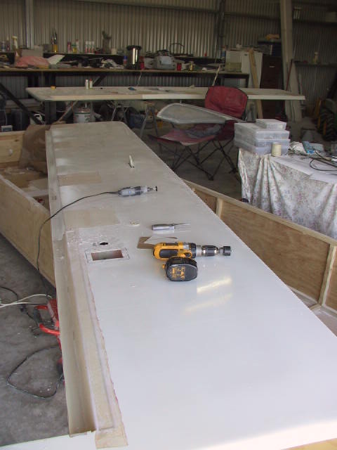

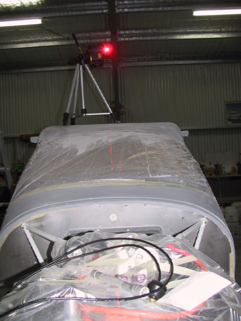

In reposnse to Clem's note about the wing inspection openings, I have just been out in my shed tonight getting up to mischief with a bright torch. With the lights out you can see right through the wings with the torch below and the Jabiru's cutout marks look to be in the right spot and outboard of the rib.
If you haven't already, Ross, I suggest that you have a check using that method before you cut. Let me know how you go.
I have also tonight done the holes in the fuselage for the Transponder antenna and the UHF antenna.

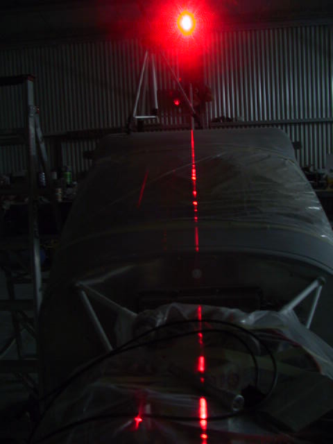

Also did a heap of laser alignment checks now that the engine is on etc and it all came up spot-on .... which is nice to know, what with the offset of the engine mount and the engine itself.
Regards Geoff

You'll need to use that laser unit for your wheel alignment if you can work out how to adapt it - yet another job for you to do. They all add up.

Started on the wings this arvo and have the 1st stage done on both of them.

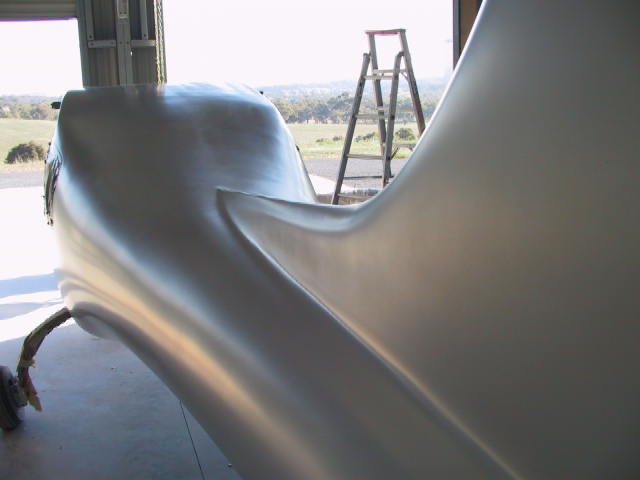

Final undercoating of the fuse was done this morning. Nice result and not one blemish to be seen, except where a couple of local blowies did the 2-step before it dried. It will all come out nicely in the final sand.
Not a pin-hole to be seen.
