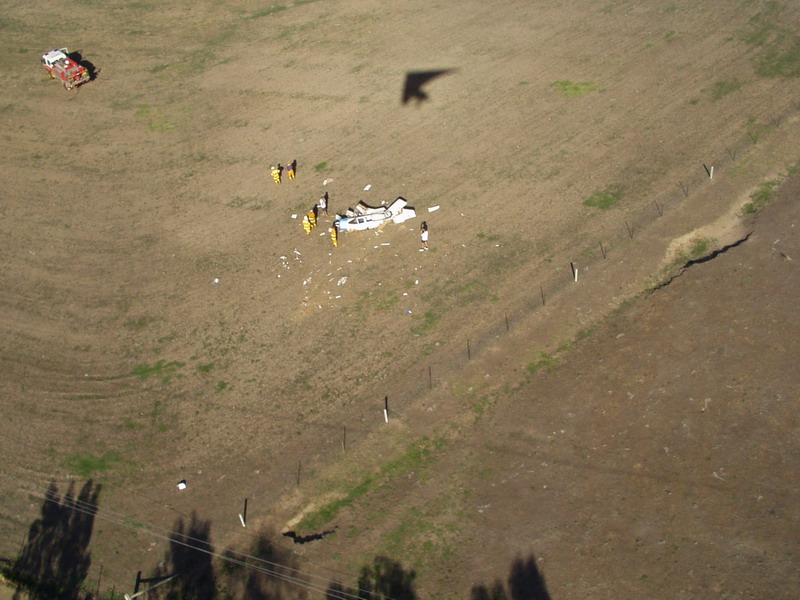

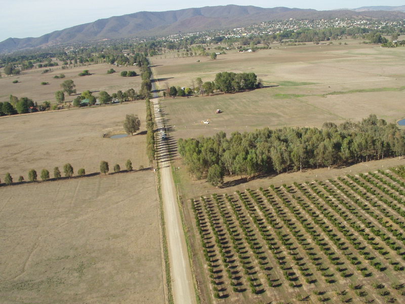

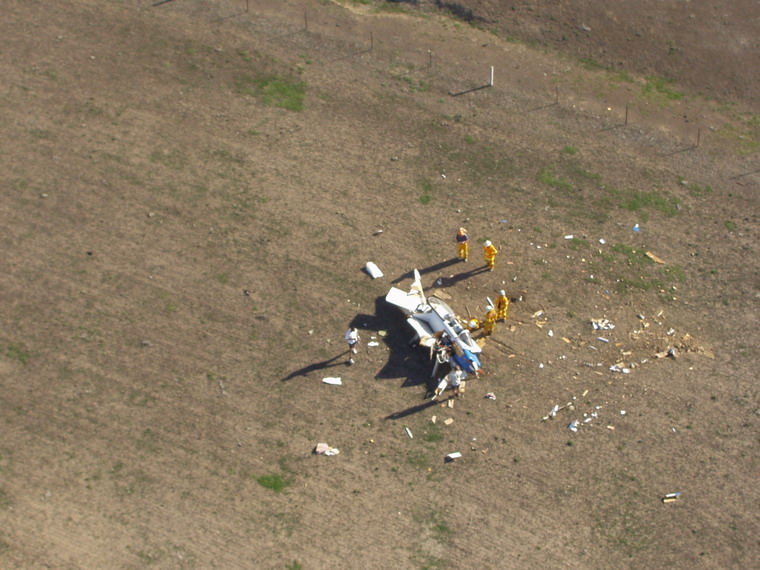

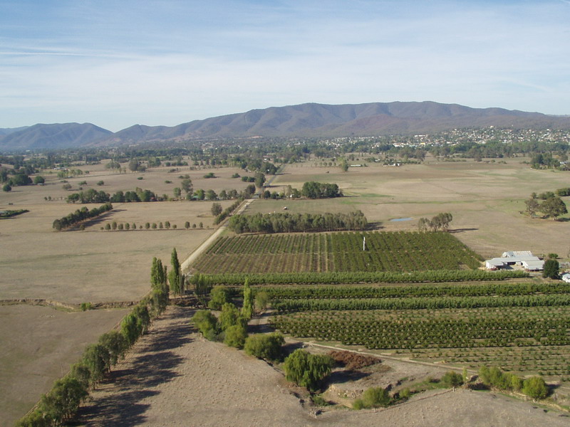

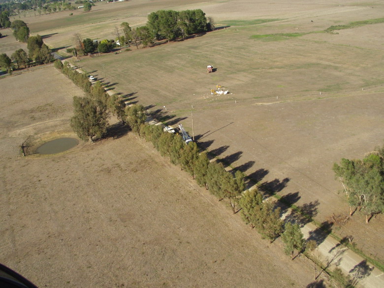

slartibartfast Posted March 8, 2007 Share Posted March 8, 2007 Yet another wire strike occurred on Sunday. Thankfully, this time the pilot walked away with nothing more than a scratch on the noggin. I heard about this Monday, and saw a photo of him standing in front of the wreck. I don't have that photo, but I asked the CFI at Tumut (Peter Wilson) for some snaps and to confirm some details. He sent me the following photos. He couldn't remember the plane type (nor can I) but it was wooden and homebuilt. What was it Jack? The wood probably saved him, as it went in wing over wing and absorbed a lot of energy crumpling them. He missed an approach and tried to go around, but he could only get half power (don't know why). He tried for a paddock (as you will see in the photos - there are heaps to the south of the runway 17). He seems to have picked the wrong one and clipped the power line. Peter took these photos from his trike a bit later. [ATTACH]1519[/ATTACH][ATTACH]1520[/ATTACH][ATTACH]1522[/ATTACH][ATTACH]1521[/ATTACH][ATTACH]1523[/ATTACH] Not the sort of wreck you expect the pilot to be posing for photos in front of. I'm very glad we weren't mourning another loss. Ross Edit: Just found this report which confirms it was Tony Urbancik's plane. He is from Canberra and the guys were thinking it was probably his - especially when we saw the rego - VH-URB. Link to comment Share on other sites More sharing options...

Student Pilot Posted March 8, 2007 Share Posted March 8, 2007 How old is he Authur? I talked to him a year or two ago now just before he test flew it, I'd guess at 65? If you have a close look at the wreck you can see the very distinctive canopy. There are quite a few paddocks to put down round there, looks like it's a swer line that he hit, maybe it was afternoon and he was looking into the sun? I think he had a 360 in it, not sure if it was an 0 or I, if was an I that would have ruled out carby ice build up on approach. There aren't many Sorroco's flying in this country, they perform pretty well. Link to comment Share on other sites More sharing options...

Ultralights Posted March 8, 2007 Share Posted March 8, 2007 those photos would make great educational tools in highlighting how difficult it is to see powerlines until its too late, even when the conditions are favourable as they are in the pics, the light behind the pilot and the lines cant be seen until your pretty much on top of them.... can these photos be used and shared to highlight this danger??? Link to comment Share on other sites More sharing options...
slartibartfast Posted March 9, 2007 Author Share Posted March 9, 2007 those photos would make great educational tools in highlighting how difficult it is to see powerlines until its too late, even when the conditions are favourable as they are in the pics, the light behind the pilot and the lines cant be seen until your pretty much on top of them.... can these photos be used and shared to highlight this danger??? I totally agree, as I'm sure Peter would (he took the photos). Peter took off on 17 and flew the same path Tony would have on the go-around (only higher), so it gives a great progressive look at the options. Personally I would expect power lines along a road like that - they would almost always be there. The poles are fairly visible too. In no way do I mean to be critical of Tony - he would have been very busy. I merely offer that opinion for further comment and education. I doubt the sun in the eyes was an issue, as the path is due south and the shadows are almost west and long. It must have been fairly early morning. As I said, I'm glad he survived and we can learn from this without emotion. Short version: feel free to use the photos. I have 1600x1200 pixel versions. Ross Link to comment Share on other sites More sharing options...
