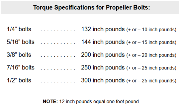

BrendAn Posted June 17, 2023 Share Posted June 17, 2023 Can anyone tell me what tension I need for a sweet apple prop on a 582. From what I can find on the net 200 inch pounds may be it but there is a lot of conflicting info out there. Tia. Link to comment Share on other sites More sharing options...

pluessy Posted June 17, 2023 Share Posted June 17, 2023 I would check other manufacturers data that make wooden props. Main criteria is bolt size and some times hub thickness. Wood type could also have some influence: From Culver props (left) and Catto (right): Link to comment Share on other sites More sharing options...
BrendAn Posted June 18, 2023 Author Share Posted June 18, 2023 8 minutes ago, pluessy said: I would check other manufacturers data that make wooden props. Main criteria is bolt size and some times hub thickness. Wood type could also have some influence: From Culver props (left) and Catto (right): Thanks for the chart. I don't think the sweet apple prop maker is around any more. There must be people on here that have owned s a props. They were Aus made. I think I will go with the 144ip on your chart and see if it holds that torque. Link to comment Share on other sites More sharing options...
