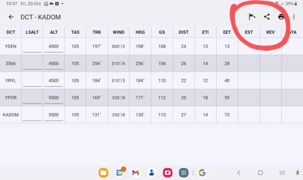

coljones Posted October 20, 2023 Share Posted October 20, 2023 If you go to the plan sheet and put in the altitudes and then click on the windsock (top row icons you will be given a range of times. Make a selection and the wind at allude will be displayed and the wind corrected calculated and entered on the sheet. 1 Link to comment Share on other sites More sharing options...

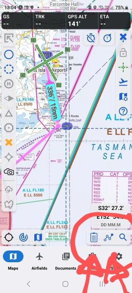

coljones Posted October 22, 2023 Share Posted October 22, 2023 (edited) Down the bottom RH corner are the search plan and sheet icons. The sheet icon only appears if you have started a plan. Click on the sheet icon to bring the sheet up. The OzRunways document page has the manual and a guide. I am using the Android RWY version. They are similar. Edited October 22, 2023 by coljones Wrong image Link to comment Share on other sites More sharing options...
