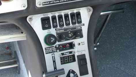

Flight Design have added a new switch adjacent to the Flap selector. (see photo). According to reports on the U.S. website, there had been some problems with the flap motor tripping due to pilots selecting a setting (say 30) then selecting a lower setting (say 15) while the flaps were still running to 30 degrees.
Here is an explanation from Tom Peghiny (a U.S. Flight Design dealer).
"The little black rectangle should have been placarded by the
factory (and it will) but it is a double circuit breaker for the
flaps, not a reset button. It has a 1 AMP breaker for the flap board and a 10 AMP breaker for the motor all in one unit. The way to reset the flaps is to pull the left main breaker and reset it. Also read up on the manual override option on the flap switch in the AOI.
Please advise the forum. TP"
Thomas A. Peghiny
