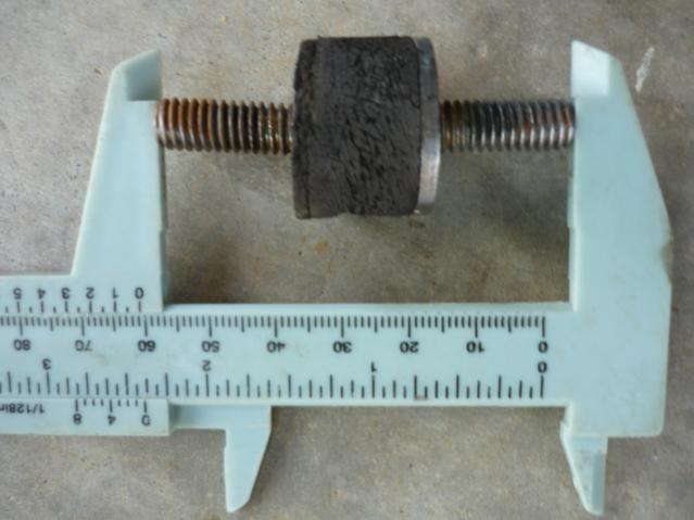

pudestcon Posted March 15, 2010 Author Posted March 15, 2010 Sorry for the late response icebob, I was just reviewing this thread and saw I didn't respond to your last post. Thanks for the advice on the welding. In the past I have done a bit of oxy acetylene mild steel welding but don't have the equipment any more so I'll just get someone to do it for me. I've cleaned up the exhaust now and its about ready for the primer and paint. I now need 2 support mounts like the attachment here - hope they are a common item. Cheers, Pud
icebob Posted March 16, 2010 Posted March 16, 2010 Hi Pud, Yes these are common parts, my last lot I think I got from Supercheap auto or one of those, there are two types one with metric thread and one with imperial thread, took a nut with me to make sure. Thay lasted two years for me at around $6 each that was cheap. Bob.
pudestcon Posted March 16, 2010 Author Posted March 16, 2010 Thanks Bob, I appreciate your advice Pud

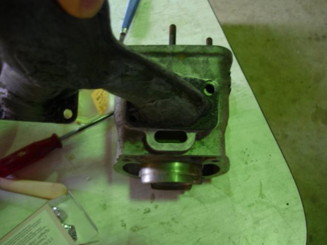

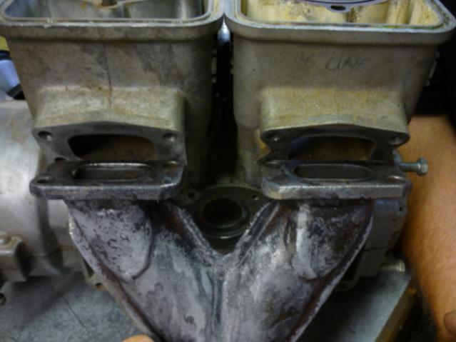

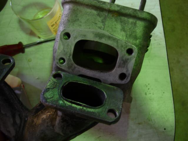

pudestcon Posted March 21, 2010 Author Posted March 21, 2010 The exhaust saga continues.... I found out during the week that the manifold I have for the 582 is actually off a 503 and only has 2 bolt holes on each fixing plate as opposed to requireing 4 bolt holes on the 582 - the hole position is different too as is the actual size of the base plate. See these photos and you'll see what I mean. I think I'd better give Wal at Bert Flood a call:idea: Pud
icebob Posted March 21, 2010 Posted March 21, 2010 Holy....S.... Batman, not good what about the rest of the motor any interchange of parts? The aircraft repairs done in the past to me may need checking for not to standard works, an uneasy feeling here. now you may find with a new manifold the mounts from above are located differently too, what about the springs are they good ones(resting length and thickness)? Bob.
pudestcon Posted March 25, 2010 Author Posted March 25, 2010 Quote Holy....S.... Batman, not good what about the rest of the motor any interchange of parts?The aircraft repairs done in the past to me may need checking for not to standard works, an uneasy feeling here. now you may find with a new manifold the mounts from above are located differently too, what about the springs are they good ones(resting length and thickness)? Bob. Thanks for your exclamation Bob:big_grin: Don't worry, I am fully aware of the potential issues but am confident all will be correct once we get to test flying day!!! A new manifold and springs will be purchased to solve the current issue. Cheers, Pud
