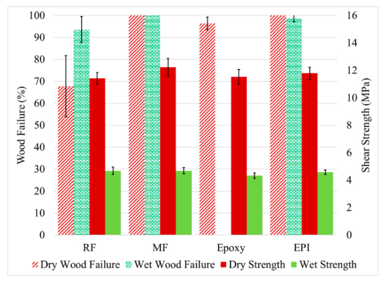

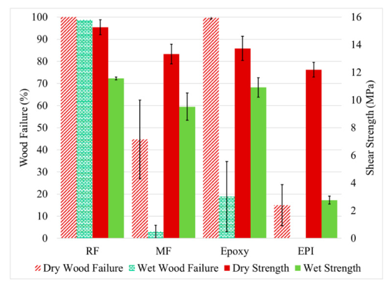

Sorry for the long post but while you may have studied forestry you didn't study engineering. 😉 The key here is repeatable research rather than belief and proclamations from on high. Epoxy glues are fantastic however they shouldn't be used blindly and their limitations should be well understood, especially when using them in things which can cause you harm. I'm not saying that resorcinol is an easy glue to use, it's harder than epoxy to use however used correctly creates a better bond. I know that there are a lot of opinions in this area however the rigorous studies all point to poor bonding qualities with timber when exposed to moisture. While there are lots of different epoxy formulations chemically they're very similar and the bonding results are the same. Happy for you to demonstrate the error of my ways however I haven't come across any testing programs where epoxy bonds in wood exposed to testing have survived standard de-lamination testing methodologies except where a primer such as resorcinol is used on the wood surface. Epoxy is gap filling, easy to use and readily available. You just need to be very careful when using it as a bonding agent for timber, especially in harsh environmental conditions. Attached is the appendix of Classic Boat which provides a professional boat builders opinion, also attached another study which tested both wet and dry wood failure on four different glue types including epoxy. In the conclusion epoxy actually bond more effectively to acetylated wood, but not unmodified wood. The paper Hydroxymethylated_resorcinol_coupling_agent_for_en.pdfHydroxymethylated_resorcinol_coupling_agent_for_en.pdfHydroxymethylated_resorcinol_coupling_agent_for_en.pdfHydroxymethylated_resorcinol_coupling_agent_for_en.pdf Starts with the following quote which is relevant for anyone considering using epoxy for externally exposed structural purposes. Resorcinol Formaldehyde can be set at room temperature or can be heat set. Phenol Formaldehyde PF is a very similar adhesive to RF and is often mixed with RF to create RPF adhesives which can also set at room temperature. Australian Standards specifies Type A adhesives for marine ply, both RF and PF are classed as Type A. RF is more reactive than PF and in some cases will bond with timbers more successfully than PF. The main reason to use PF rather than RF is price. RF is more expensive hence its limited use in this role. Actually RF is classed as a phenolic compound, it just has more reactive groups enabling lower temperature reactions. The main reason for changing glues is price and ease of use. This page give a good overview https://www.matildaveneer.com.au/stuck-on-you-plywood-glue-bonds/ Type A (A-Bond) This is the strongest bond and is also waterproof. It’s produced from a phenol formaldehyde resin that is set under heat and pressure. The result is a permanent bond that can be exposed to heat, cold or wet conditions for a long time without deteriorating. This glue bond is used for structural, exterior and marine plywoods. Type B (B-Bond) Less durable than Type A, a Type B glue bond is waterproof but will deteriorate after several years being exposed continuously to weather. It is usually produced from a Melamine-urea-formaldehyde (MUF) resin. Plywood with a B-Bond is best used in situations of limited weather exposure, e.g. exterior doorskins and concrete formwork. Type C (C-Bond) This glue bond can only withstand occasional exposure to dampness and as such is most suitable for general internal uses. It should not be used for structural applications or wet/damp areas. This glue bond is usually produced from urea formaldehyde (UF) resin. Type D (D-Bond) Similar to Type C, Type D is also made from urea formaldehyde (UF) resin. D-Bond Plywood is best suited to internal uses where it is completely protected from wetness or dampness. It should never be used for structural applications. Australian structural hardwood timbers are significantly stronger on average than softwoods and hardwood species used in the northern hemisphere, using standards methods of testing strength which is measure in force per unit area. I'll list a few of the accepted timber strengths. Grey Ironbark Modulus of Rupture 185MPa Spotted Gum Modulus of Rupture 142MPa Rose Gum Modulus of Rupture 119MPa Hoop Pine MoR 90MPa Norway Spruce MoR 63.0MPa Sitka Spruce MoR 70.0MPa Radiata Pine MoR 81.MPa I could go on but you get the drift. Happy for you to add your own figure with published Module of Rupture figures. You can also get an idea of the timber strengths from the following link which shows European glulam beam strength vs Australia standard strengths https://ash.com.au/blog/gl-au-nz-vs-europe/ . The main reason for the difference is the fundamental difference in strength of the base material, Australian hardwoods being stronger lead to significantly higher engineered wood ratings. In fact there is growing interest internationally in using Eucalypts originally grown for pulp, for engineered wood due to its high strength. The main species grown in this manner is Eucalyptus Globulus which is also known as southern blue gum. An articles on this are below. https://www.ncbi.nlm.nih.gov/pmc/articles/PMC7078706/ I suspect that you've become confused by the concept of strength to weight ratio which is a related concept, which is relevant to airplanes but is a derived measurement based upon strength in MPa. Aluminium is not as strong as steel as it has and ultimate tensile strength of 90MPa in the unalloyed form and up to 690 MPa with special heat treated alloys whereas special steels have a UTS of up to 2690. However on a strength for weight basis they're pretty equivalent. But the point which is missed is that you can make a propeller from ironbark which is thinner and more efficient than one made from spruce while still retaining the strength properties in tension which is where most failures occur. Due to the increased Modulus of elasticity the propeller can also maintain greater stiffness with a thinner section. In fact based on the figures above you can have a stiffer propeller with half the thickness. ClassicBoatAppendix.pdf glue-comparison-strength2021.pdf
Resorcinol penetrates and chemically bonds with the wood, this is one of the things which makes it's bond so durable. Very early Mosquito's were built with casein and later versions with urea formaldehyde. https://en.wikipedia.org/wiki/De_Havilland_Mosquito#Fuselage . Problems were found (often due to loss of aircraft) when these aircraft were deployed in tropical environments. Urea Formaldehyde while strong is not as weatherproof as resorcinol. My understanding is that later Mosquitos and some of the Australian Mosquitos were built with resorcinol which mitigated many of these issues. Not saying that the build quality was high on the Australian planes but the glue was better.
I noticed a few people recommending epoxy as a lamination glue, there are better glues, epoxy has a poor record compared to other glues in relation to resisting de-lamination and glue-line failure. About all it has going for it is that its easy to use. Epoxy is good with fibreglass and carbon fibre but not wood. I'd be wary of a plane build with epoxy. The gold standard for wood glue is resorcinol, it is the glue recommended in most plane building standards and is also in the Australian Standards for commercial exterior glumlam glues. Basically moisture penetration weakens the epoxy-wood bond permanently even after drying. Is your prop likely to ever get a stone chip and then get rained on or fly through a shower? Resorcinol is the glue used in marine ply and was also used in WW2 to fix the Mosquito delamination issues in tropical environments. One thing to note is that resorcinol doesn't have gap filling properties and requires a relatively high clamping pressure which shouldn't be a problem when making propeller glulam blanks. Some isocynanate and PU glue also have good results however results vary across manufacturers and formulations. A lot of research has been done in this area I've attached one paper and the text from it is below. The research was looking at gluing acetylated wood, however the control was un-treated wood and the text relating to epoxy is pretty damming. An example of a primer is a resorcinol primer applied to the wood surface which chemically bonds with the wood surface and achieves a strong bond with the epoxy. Australian woods are significantly stronger than their northern hemisphere counterparts, for example ironbark has a tensile strength about 2x that of english oak (famous for it's strength) however they are difficult to glue, however this strength provides the ability to create a thin strong prop which is appealing. Again resorcinol glue appears to be about the best adhesive in this regard according to research done by the Queensland Government which is about the only Government agency actively doing research in this area which is a pity as from an engineering perspective these timber have great structural potential. Also if you're going to the trouble of building a propeller you can use the wonders of computer software to get an optimal design for a particular speed and generate a cad file and have a machine carve your blank. I think that I generated this using https://web.mit.edu/drela/Public/web/qprop/ but it was a while ago. Unless you have thousands of HP big paddle shaped things are far from optimal, thinner designs with an airfoil that goes towards a point will provide a significantly better outcome. Below is an airfoil generated to provide optimal thrust at about 160 knots with about 180 hp. glue-comparison-strength.pdf
